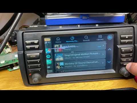

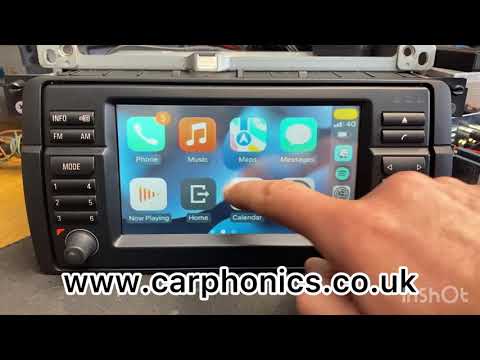

          Thank you for the kind words and review. It was an absolute pleasure dealing with you and the mechanic.
          One of the best features of this, is that it starts up as soon as you unlock your car, rather than ignition on, which is a big bonus over the dynavin and other aftermarket systems.
          I made a quick video recently. I will redo it when I have time, but it explains it a little more and you see it in action.
          https://youtu.be/72bA4Ce3GZo?si=vsyl4rsWmDxNbW1Wm

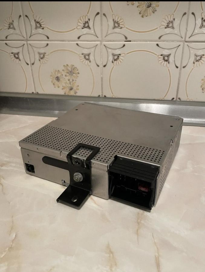

                      The mk4 navigation unit the trunk, controls what comes on the display and right side buttons. If you have tv tuner fitted, then the video output from mk4 nav goes into tv tuner and then to the monitor up front. If the mk4 is removed, the tv tuner is like a backup and takes control of the screen and right side buttons, because it has its own operating system. Meaning there is no point of having the mk4, unless you want the full OEM retrofit as well.
                      I run my car without the mk4 navigation unit.
                      Under the cd changer in the trunk, you will have a slot for the bm53 and the tv tuner. You may need the silver clips the screws go into. Same as the ones on the cd changer. Or just take them off the cd changer, as it has 4 of them. The bm53 does require the L shape little bracket.
                      I have attached a photo of it.

                        Perfect. That explains what that little bracket I found on realoem is for.
                        So this one is not actually needed for the tv tuner?
                        2003 E46 M3 TiAg/Cinnamon 6MT
                        2005 E46 330i ZHP Imola/Sand
                        Instagram:@thegenius46m
                          #57
                          Yes, the clip and nut. I can provide this, if you let me know before shipping back to you. I have loads in stock.

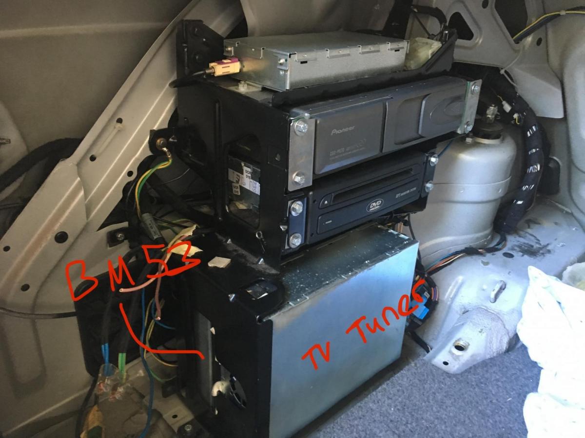

                            Do you happen to have a picture of all the modules needed in the trunk installed? I'm just curious how it's all mounted for what's being used
                                Sure, please see attached photo.
