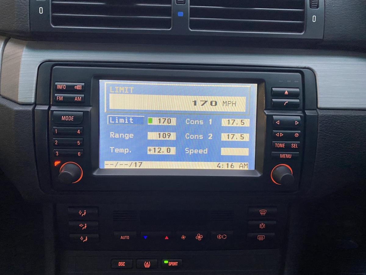

              Will all the standard car functions like consumption displays work without the mkiv unit if I use the tv tuner solely to power the headunit? I guess what I'm curious is how the car is pulling that information from the canbus? Is the data being fed to the trunk into the tv tuner via ibus?
                It will still display all that when you select computer on the OEM screen, via the tv tuner. I will take a screenshot from my car and post it up.
                      This is what the TV tuner trip menu computer looks like, when you don’t have the navigation plugged in.
