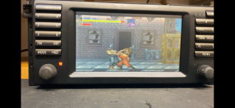

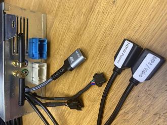

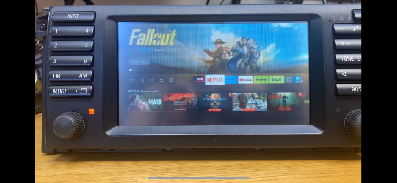

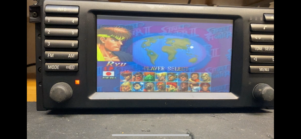

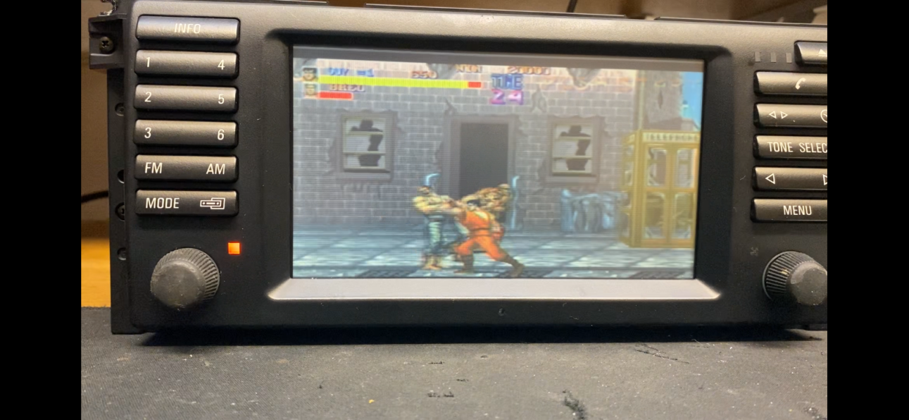

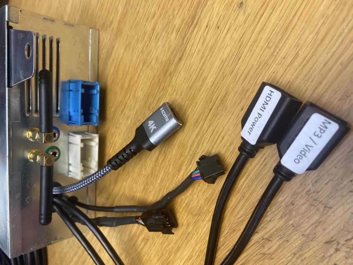

              Just did an e39 m5 customer in the USA, and added a HMDI input.
              Tested it out with an Amazon firestick and a little gameboy device which has a hdmi output.
