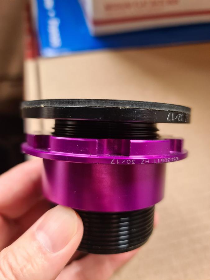

                  To further clarify, I've added a pic of the height adjuster. Turn to the left and it will raise the height. Turn to the right and it will lower the height.
                    If mounted on the vehicle in this orientation shown, above the spring, yes.
