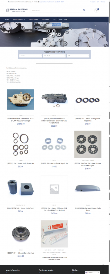

    I'm getting few rebuild quotes from local indy shops in Raleigh, NC area.
    One of them is shown below.
    Look for feedbacks on the below quote. Few parts are bit higher but it is what it is in current inflation climate.
    I've asked the shops to throw in any other preventative things to do while doing the vanos lockdown with engine cover off, including valve adjustment, valve cover gasket (although i'm reading this gasket itself can be reused), timing chain tensioner, spark plugs, and even fan clutch (reading from elsewhere in Internet).

    You could get new sealing plate o-rings from besian and vanos gasket from any OE parts vendor. Can do a solenoid block cleaning. No need for rebuilt solenoid if no codes, esp since some of the rebuilds are DOA anyway.
    My 04 with 182k no issues over 14 years, though I did succumb to the fear back in 2014 and had a besian disc put in (tabs were fine). My 02 with 130k no issues, didn't even have a single knick on the dics/tabs.
    This won't be a popular opinion. Most feel you should spend thousands on a non-problem based on unfounded, statistically unproven fear.
      If the exhaust hub tabs are not broken, that's a $500 savings right there.

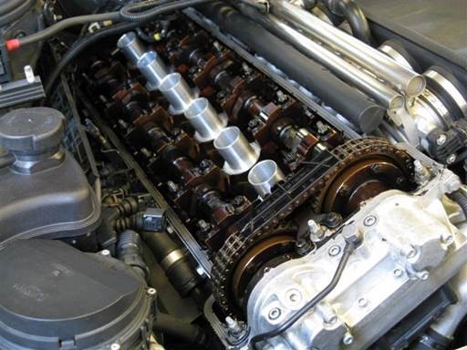

        With valve cover off, as shown in the picture below, but with vanos still attached, examine the tabs/discs?
        If the vanos has to come off the inepxect the tabs/discs, then was looking at replacing the vanos gasket.

            You can use a flash light to see the tabs. Rotate the engine with a 24mm spanner on the cams.
              Thank you, i'll have those areas inspected first (and probably should have considered that from the beginning) and start small in repairs as needed. I'm going to capture notes along the way and share here.
                I'd rotate the engine from the crank not the cams. Could be totally fine, but something doesn't feel right about putting a hollow cam in torsion with an open ended wrench that probably doesn't fit perfectly on the hex thing.
                  To echo the above, i was able to see my hub tab partial cracks with the vanos unit still installed. Look closely at the corners for any darker lines.
                    If going down that route I cannot stress enough to either get a VAC over-sized hub or have YOUR pump disc machined, basically don't get an aftermarket disc.
                      Couldn’t agree more. Sounds terrifying to rotate the motor by the cam. That rough hex casting on the cam is for small cam adjustments when fully assembled or setting/checking specs when the head is on a bench off the motor.
