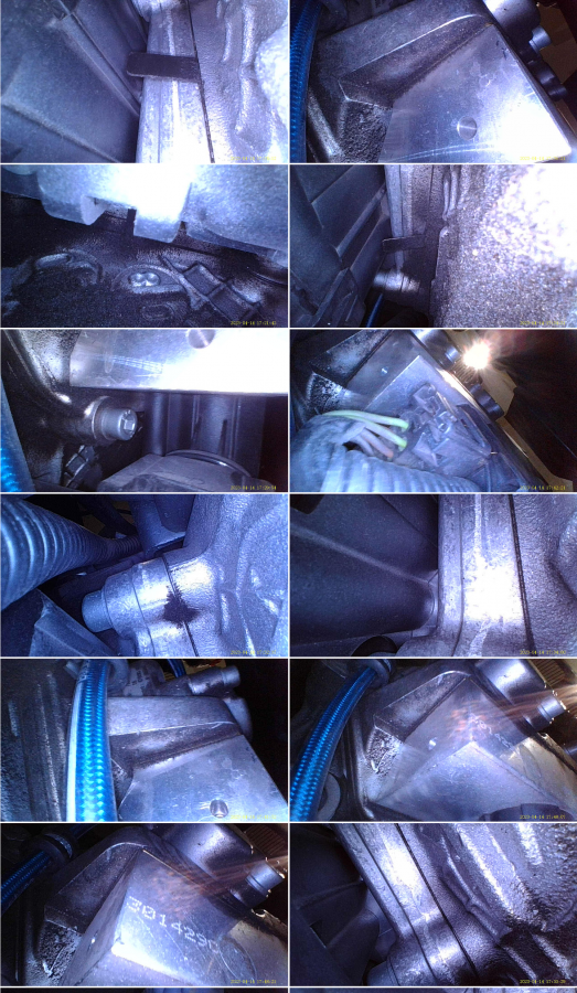

          So, picked up this borescope/endoscope gadget that do 360-degree movement, and starting to see (maybe) what's going on as the source,
          Seems like the leak maybe at the sealing plate?
          But there are those oil stains at some "odd" places...
          (Ignore the 2023-04-14 timestamp, forgot to set the date/time before using it)

            #35
            Current school of thought is,
            a) tackle the valve body removal
            b) inspect/replace seals on the sealing plate
            c) clean valve body
            d) clean the oil area as best as possible
            e) put back the valve body
            f) (spirited) drive for few hundred miles, look for oil leak in similar area
            g) if no more leak, then at closer to 30K miles get valve adjustments
            h) additional inspection in and around vanos
            i) maybe replace vanos gasket by then

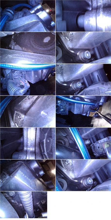

              #36
ID:	215274 Click image for larger version
              attaching.
                #37
                That's a very very minor leak.

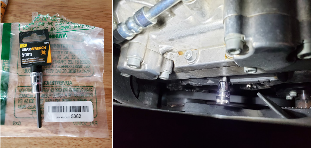

                  You can, there's access holes for those in the solenoid pack.
                  Finally, found the right length with enough clearance to put a 1/4 drive torque wrench down there.
