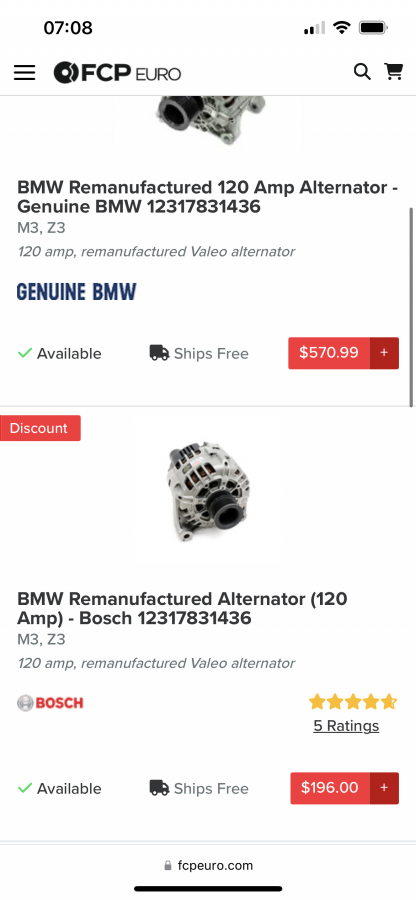

    Had my alternator go at the track this weekend, luckily found another M3 owner that had a spare one. Swapped out in and got back on track (I love how friendly people at the track are).
    His was a remanufactured Bosch, which I’ve read bad things about and the advice is to stick with OE. However when I go to FCP’s site new OE is out of production, and the OE option says remanufactured Valeo, which is the same as what it says under the Bosch. So wondering if there really is a difference now, the OE is twice the price?​

    When I needed one I went Valeo from Bimmerworld based on all the negative feedback around Bosch. Would have preferred FCP, but alas they didn't have em.
      https://www.bimmerworld.com/Engine/A...831-436_2.html
      At $300 for BNIB Valeo, it's not worth getting a refurb.

        Yep brand new Valeo would he my pick. I put one in about 4 or 5 years ago replacing the factory Valeo which had an open circuit rotor.
          I went with the reman Bosch on mine before seeing all the negative feedback. It's been close to 2 years at this point with absolutely no issues though.
            I’ve seen a couple of Bosch rebuilds that had worn brushes, looks like they didn’t replace the regulator.
            If you can get an OEM reman then it comes with a limited lifetime warranty.
            Valeo is probably your best bet. I’d check the regulator first. I’d also look at the alternator that went bad - probably a worn out regulator.
              Ordered the Valeo, get to do it all over again. Will keep the Bosch as a spare.
