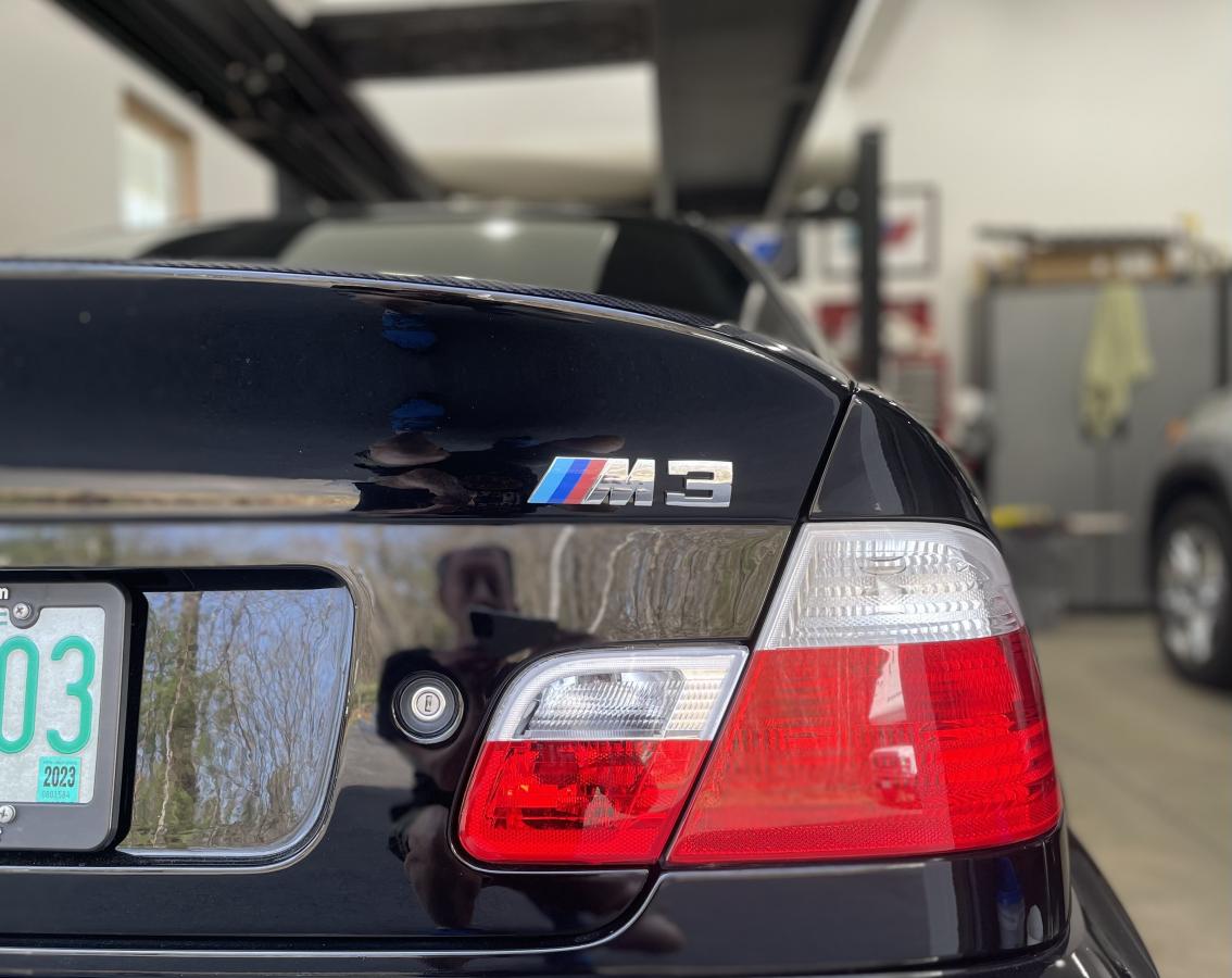

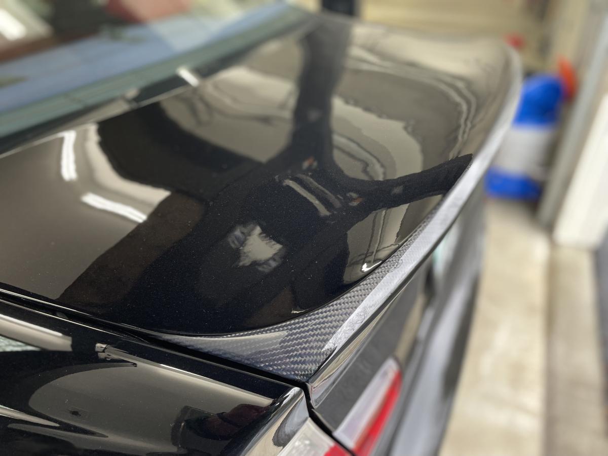

    I just upgraded to Status Gruppe carbon CSL trunk lid - very happy with the end product.
    I wanted to have a 2 strut solution, so here's what I've found.
Name:	CSL Trunk.jpg
    The body shop (Sublime Restorations) did the fitment and paint - I like the small area of exposed CF they left. Helps pick up the CF splitters on the CSL front bumper.

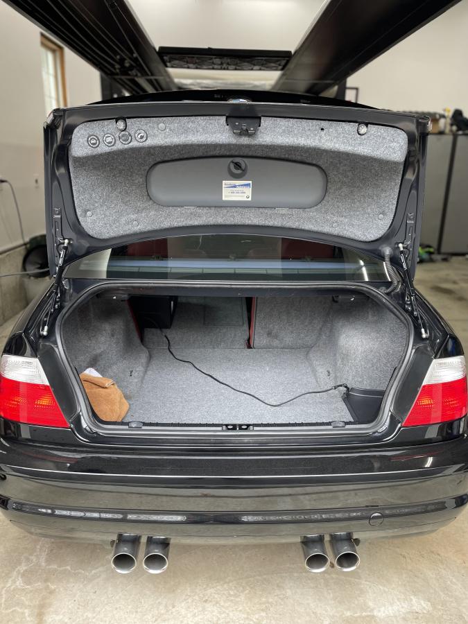

    The alignment looks pretty good, you got any pics with it open so we can see the struts?

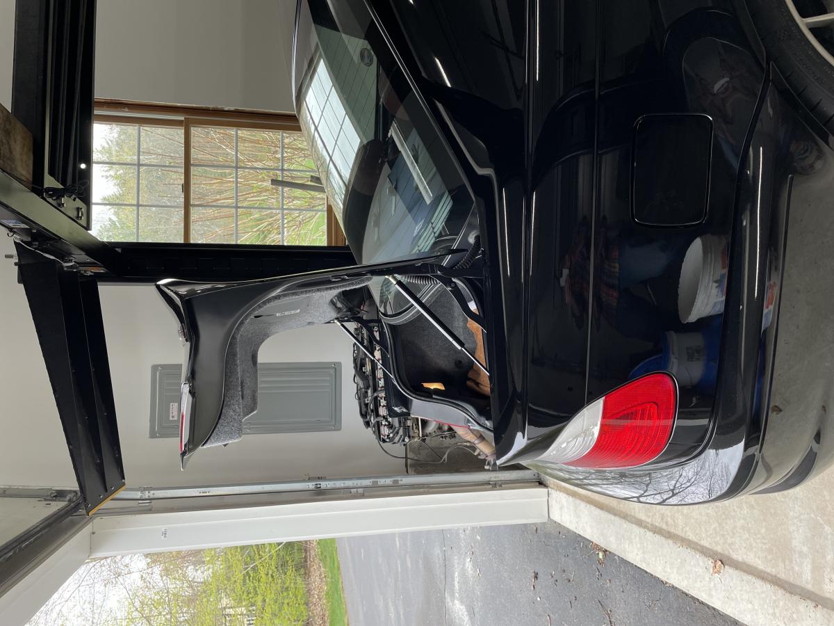

              Here's a couple of pictures of the open trunk.
Name:	open trunk.jpg
Name:	trunk angle.jpg
              Sorry for 90 degree shot - pic I uploaded was OK, ran into this before, I'll figure it out

                Badge looks a little crooked but otherwise very nice
