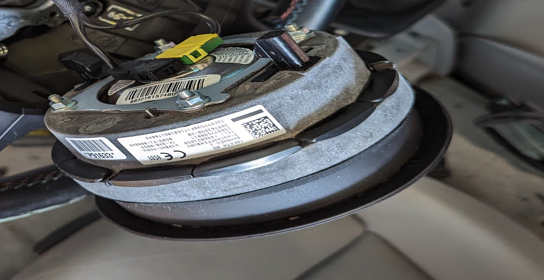

          This is super annoying. Just checked my car and it doesn't match up with either picture. No serial number in the same format as above either:
          Click image for larger version  Name:	20230504_110422.jpg Views:	186 Size:	132.5 KB ID:	216373
          New owner here - I only have one crappy picture I took when redoing my wheel trim and all that so I knew how to put it back together. Mine looks like yours. I put my VIN in and it said 0 open recalls. I know the previous owner did the first round of recalls. So I guess we're in the clear? If you find out, please share - thanks.

                  Just checked mine and it's the same as you guys. These are marked TRW Airbag Systems gmbh (part of ZF) not Takata.

                        Pull it and check the mfg. on the tag. Takata had the issuesbut Takata was also a replacement mfg. that might be good according to the docs above. TRW (part of ZF) was another mfg. we've found in this thread and I have not heard issues with them over the years.
