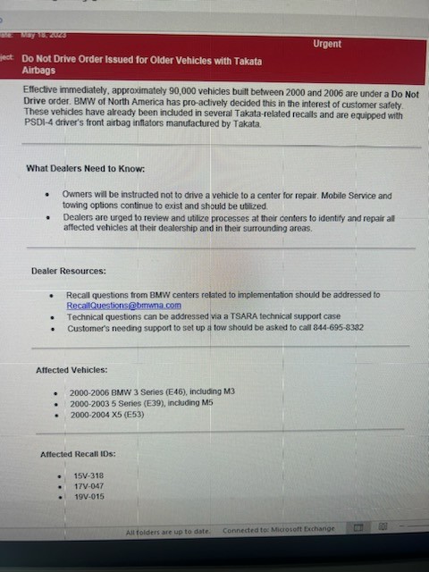

    Recall 19V-015: Only applies to vehicles with sport steering wheel. Check based on pictures I sent. Serial number needs to start with BAM xxx-1085 to require replacement.
    Recall 15V-318: If recall shows open by VIN, replacement is required
    Recall 19V-698: Check based on pictures I sent. Serial number needs to start with BAM to require replacement.
    Recall 17V-047: Check based on pictures I sent. Serial number needs to start with BAM xxx-1085 to require replacement.

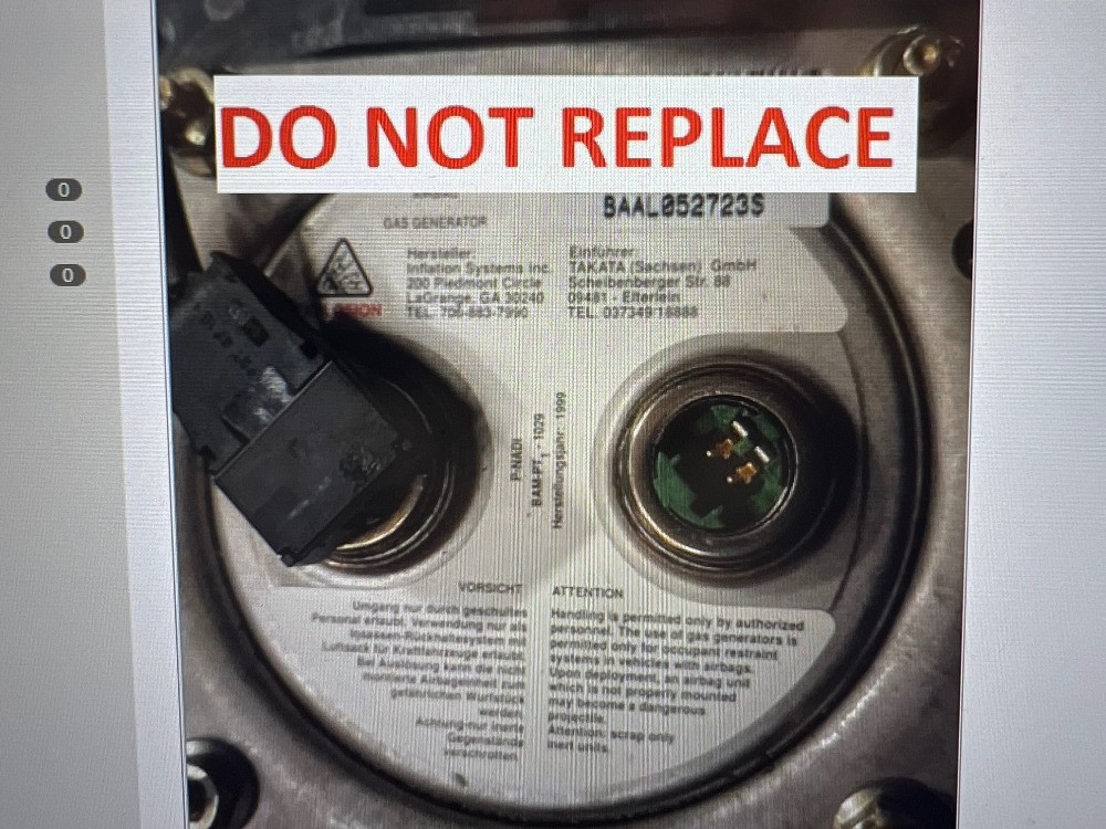

    To check yourself, on cars that are a "maybe"...
    If your airbag has a white stick on the back of it, you're in the clear:
    Click image for larger version  Name:	Untitled2.jpg Views:	0 Size:	223.8 KB ID:	216358

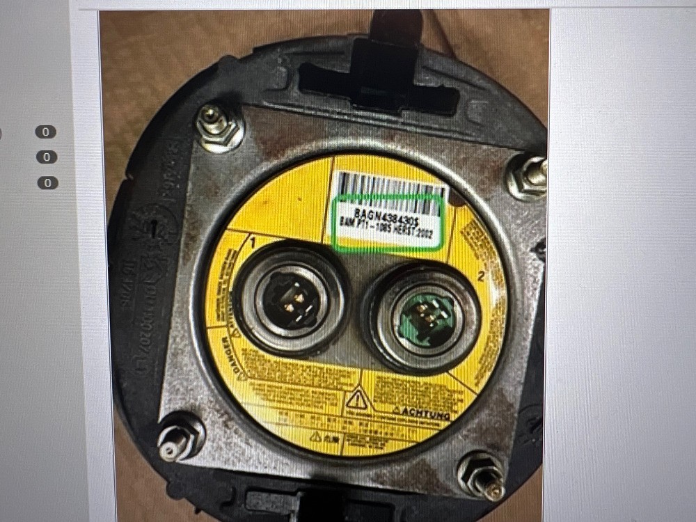

    If you have a yellow sticker on the back with BAM XXX... you need another replacement.
    Click image for larger version  Name:	Untitled.jpg Views:	0 Size:	224.3 KB ID:	216359
