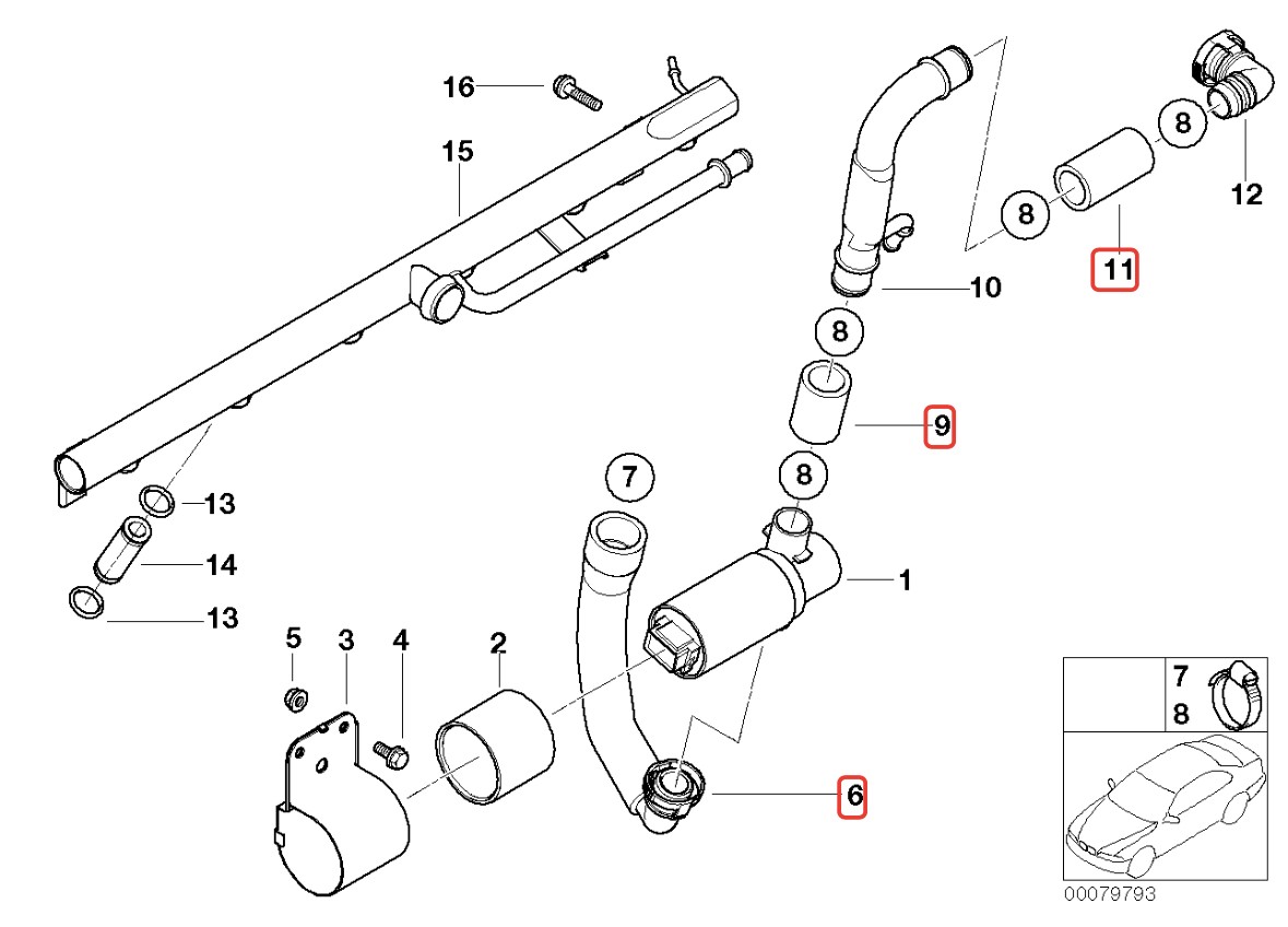

          Inspect these hoses for dry rot. A couple on my silver car were dry rotting, so I replaced them. Ridiculously expensive for what you get, but it is what it is.
            Click image for larger version  Name:	8EF75564-3D9D-4375-AA21-989428B76528.jpg Views:	93 Size:	115.1 KB ID:	223307
            I checked all the ICV plumbing and part 7 was a little dry rotted on the outside, but the price is steep for that one hose

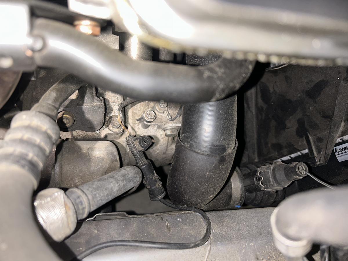

                            I think I found my problem.. maybe?
