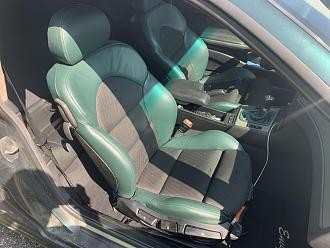

        I had a set of seats made, they look great. Bmwrestoredseats on IG. Im very happy with them. He sent me swatches and all that stuff to see what different options were available and to help me make my decision. Admittedly, im not a fan of alcantara, so i went with a non-factory e46 option, but ultimately, i have leather bolsters with m-fabric (e36) inserts and i love them. It wasnt cheap, but good work never is.
        I would do it again without question

              you can see his work here. I know everyone has their opinions on what is or isnt good work and all i can say is that as someone who put my money on the line, im a happy customer. Joni was great to work with and when you meet him, the first thing that sticks out his he is someone that goes home at night proud of what he does. I dropped my car off, went and partied in bridgeport for a night and picked up my car in the morning with new, gorgeous seats that were exactly what i wanted.
