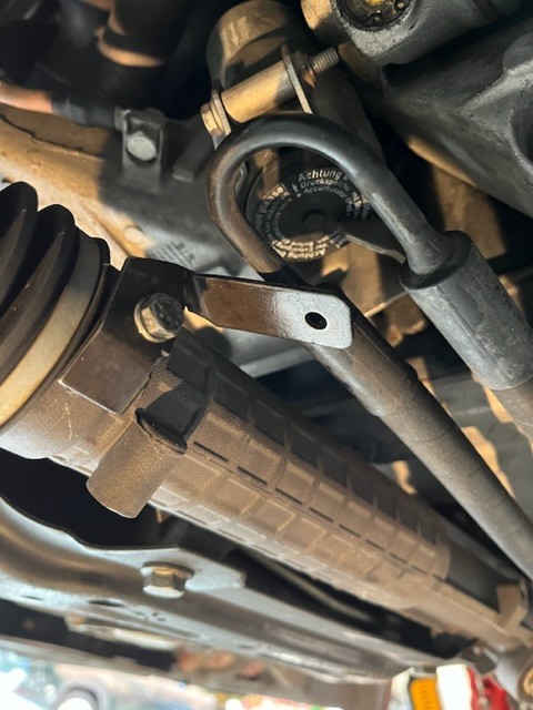

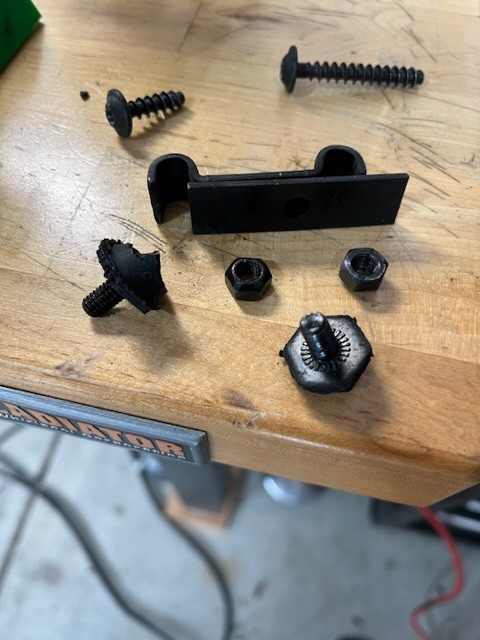

                    I did break this, power steering hose bracket. Can anyone help me with a part number for the rubber piece that broke?
                    ‘04 M3
                      I did the same thing when changing my mounts. Fortunately I was also doing my power steering lines at the time, the new hoses came with a new isolator. PN/link for the isolator is below:
                      PN: 11727559515
