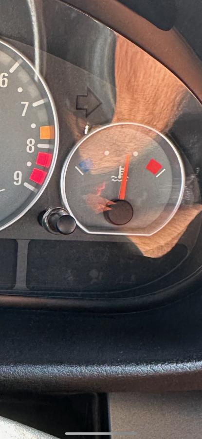

    1. Initial overheating resolved by cooling system refresh. Temp gauge did not pass the dot between center line and adjacent dot as pictured below. OEM BMW radiator, water pump, aux fan/temp switch, radiator hoses, and high temp o-rings were replaced. Thermostat, oil/coolant temp sensor, and expansion tank were recently replaced and left along with the aux fan and fan clutch.
    2. Water temp needle position may have gotten thrown off during the overheating episode, resulting in a needle position that was off center despite optimal coolant temps. I performed a gauge cluster reset to realign the needle. Everything is dead center after the cluster reset (video linked in my response - post 29, page 2) and the system is cooling perfectly.

    My alternator has been on the fritz for a while and I had it replaced last week. When I was driving to the shop, I noticed my water temps (which are usually dead center - I can't see the thermostat image) were leaning to the hot side slightly (I could see the thermostat). I didn't think anything of it and didn't bother mentioning it to my shop in case it was a fluke.
    I took the car for a short drive this evening and noticed the water temps were climbing by the time I hit 3rd gear / 40 MPH. Oil temps were well below 200. The warm up lights had just turned off by the time I noticed the water temps were rising. It's 70 degrees out and I was not running the AC. I pulled over, turned the car off, and checked to see if there were any leaks or obvious issues and did not see anything.
    I turned the car on and began driving to the shop that replaced my alternator...Water temps returned to normal after the 3-minute turn-off period. I noticed the water temps start to rise again as I shifted to 3rd gear approaching 40 mph. Picture of my water temps around 55 mph cruising on the freeway for a few minutes:

    By the time I reached my shop and let the car idle, the temps went down and sat just above dead center (where I can see the thermostat) and did not climb back up to the 3rd dot. Picture below:
    Click image for larger version  Name:	IMG_6699.jpg Views:	129 Size:	41.8 KB ID:	222897
    The water temps were up slightly the day I dropped the car off for the alternator job but never got anywhere near the 3rd dot. My shop insisted a little beyond dead center was normal, but agreed to do look the car over. Any feedback you can provide to help me nudge them in the right direction would be much appreciated. Never delt with overheating issues with an E46 and know this stuff can be quite the puzzle to solve. Thanks in advance.

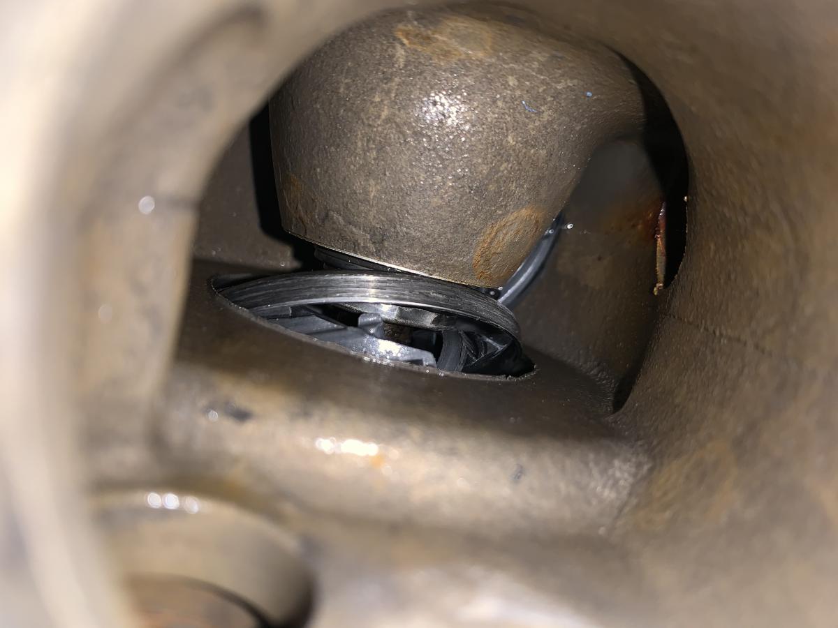

                        My bet is it’s a water pump. Check for play in the shaft or pull the thermostat and check.
                        Here’s what mine looked like when - with no fans - performed normally at idle but ran hotter at speed.
