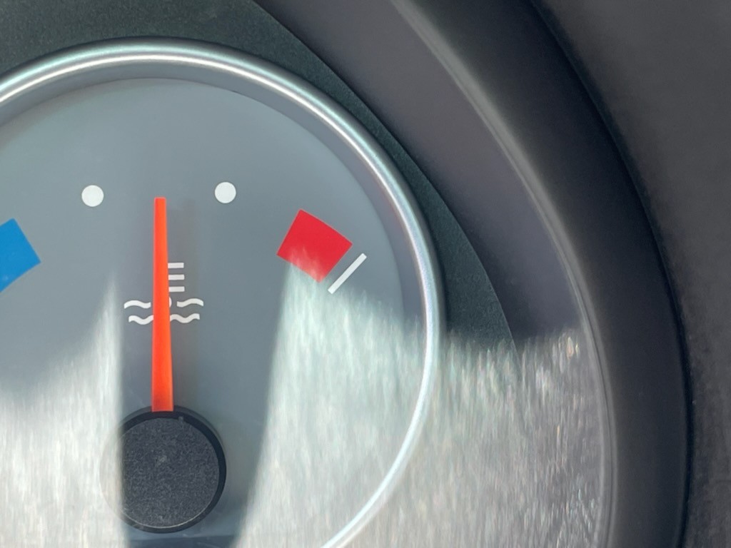

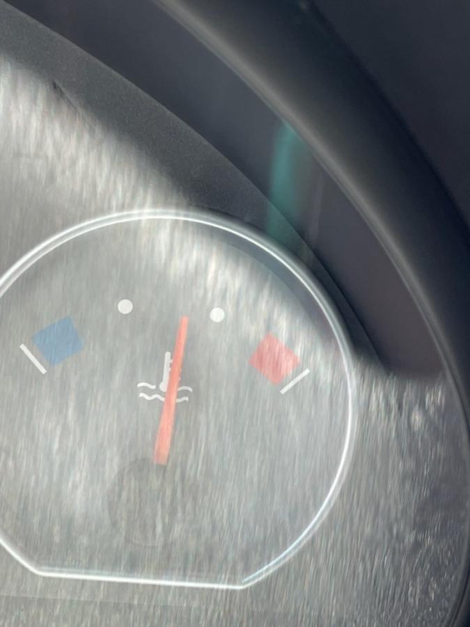

      My water temps are still off center. Not as bad as they were before (nearing the middle dot), but off center. Temps return to center when I turn the heater on and allow the heater core to evacuate some hot air. The temps are normal until I turn the AC on, and then they begin to creep off the center line.
      Car running, AC on - apologies for the glare, taken while driving.

      Car running, AC off, Heater On:

      Clutch fan was obstruction tested and appears to be running full power (could not be stopped by rolled up newspaper test). I am not sure where to go from here.
      I had my alternator replaced before all of this started happening (also OEM BMW). The alternator is showing 13.3-13.7v when operating (reading this from my Avin head unit). I've never hit 14v when cruising. I am wondering if the alternator is not providing enough power to the aux fan. See Post 55 from this thread - member installed a 140A X5 alternator and it fixed his cooling issues when his AC was on.
      Could this be my alternator not powering the aux fan sufficiently since all other major components and points of failure have been replaced?
      Open to any and all suggestions for next steps to take. Car is driven modestly around town and it is ~80 degrees out. I expect more from this cooling system...

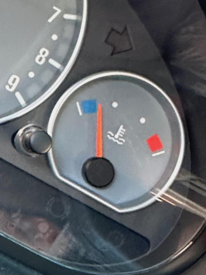

                              nextelbuddy - nailed it. It was the cluster. I think something happened behind the scenes with the motor or needle alignment when I began overheating initially.
                              Needle alignment with the car off:
                              Temps test with the car in test mode. Car reading mid -80 degree celsius but the needle was well into the hot range...
