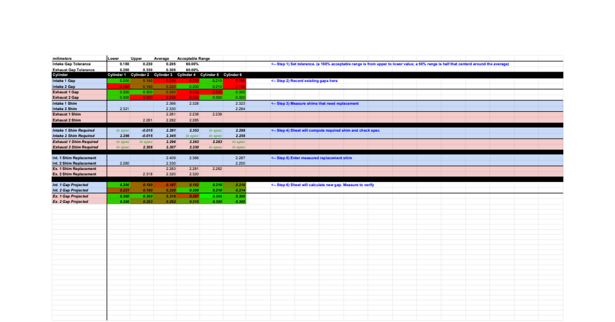

    Any tips on figuring the math a bit easier for the shims? Has anyone come up with an xcel table or similar to make things a little easier in that respect or to help with keeping a nice record of what was there and what was replaced other than pencil to paper. Math has never been my strong suit so I could use some help. And yes I know about calculators
    Someone made this on the old forum:

      I have a copy of one from M3Forum, but it doesn't look like the forum allows excel documents to be attached.
        https://docs.google.com/spreadsheets...t?usp=drivesdk
        Awesome, thank you.

            I have a spreadsheet I made a while back. PM me your email address and I can send it to you. Forum wont let me upload the xlsx file type.
