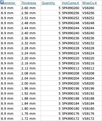

                Both Hot Cams and Wiseco sell refills, part numbers as follows, but $5.77/5 pack shipped via eBay is VERY good on the HotCams!
                Thickness Quantity HotCams # WiseCo #
                8.9 mm 2.60 mm 5 5PK890260 VS8260
                8.9 mm 2.56 mm 5 5PK890256 VS8256
                8.9 mm 2.52 mm 5 5PK890252 VS8252
                8.9 mm 2.48 mm 5 5PK890248 VS8248
                8.9 mm 2.44 mm 5 5PK890244 VS8244
                8.9 mm 2.40 mm 5 5PK890240 VS8240
                8.9 mm 2.36 mm 5 5PK890236 VS8236
                8.9 mm 2.32 mm 5 5PK890232 VS8232
                8.9 mm 2.28 mm 5 5PK890228 VS8228
                8.9 mm 2.24 mm 5 5PK890224 VS8224
                8.9 mm 2.20 mm 5 5PK890220 VS8220
                8.9 mm 2.16 mm 5 5PK890216 VS8216
                8.9 mm 2.12 mm 5 5PK890212 VS8212
                8.9 mm 2.08 mm 5 5PK890208 VS8208
                8.9 mm 2.04 mm 5 5PK890204 VS8204
                8.9 mm 2.00 mm 5 5PK890200 VS8200
                8.9 mm 1.96 mm 5 5PK890196 VS8196
                8.9 mm 1.92 mm 5 5PK890192 VS8192
                8.9 mm 1.88 mm 5 5PK890188 VS8188
                8.9 mm 1.84 mm 5 5PK890184 VS8184
                8.9 mm 1.80 mm 5 5PK890180 VS8180
                8.9 mm 1.76 mm 5 5PK890176 VS8176
                8.9 mm 1.72 mm 5 5PK890172 VS8172

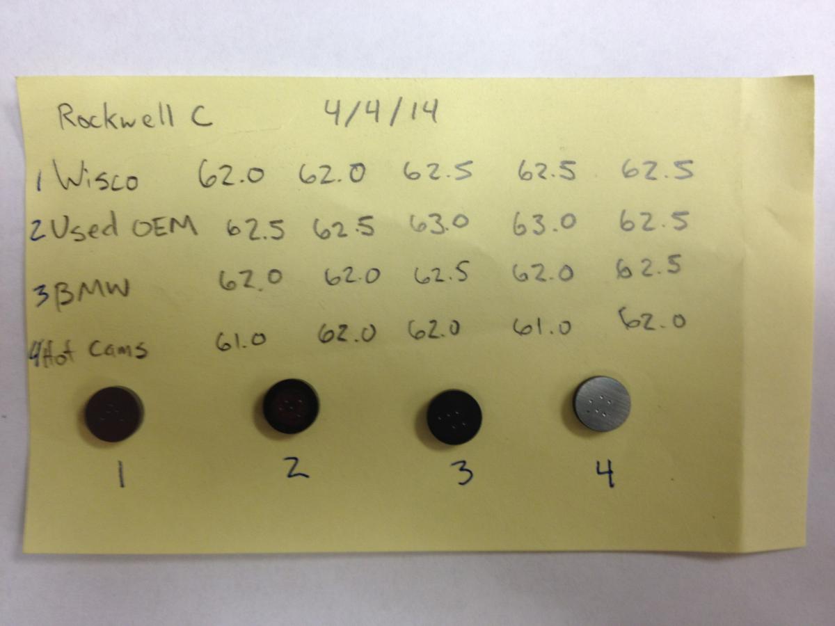

                Updated 04.04.2014: Shim hardness testing results are in - it's a match!
                Test 1 Test 2 Test 3 Test 4 Test 5 Mean StDev
                WiseCo (new) 62 62 62.5 62 62.5 62.2 0.274
                OEM (used) 62.5 62.5 63 63 62.5 62.7 0.274
                OEM (new) 62 62 62.5 62.5 62.5 62.3 0.274
                HotCams (new) 61 62 62 61 62 61.6 0.548
