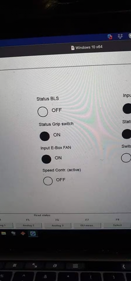

    Got the new clutch switch this AM and swapped it out. Pretty simple job. I then hooked up INPA and noticed that INPA was showing "status grip switch" as on and off as I pressed and depressed the clutch with the key in position 2. I figured I was good to go so just started the car to make sure it still started ok. But then I noticed that "switch grip status" is just stuck in the on position all the time like it was prior. I restarted the car a couple times, unplugged the clutch switch and replugged it - but now it's just showing the status as on all the time.
    I haven't test driven the car because the weather is junk here right now. No error codes yet after I cleared them before I swapped out the clutch switch. But I'm guessing that one might come back after a test drive.

              Click image for larger version  Name:	image (1).png Views:	0 Size:	334.2 KB ID:	225247
              Status Grip Switch above is referring to the Cruise Control Cut-Out switch. When it reads ON, this means the circuit is open and the status correlates to the clutch pedal being depressed.
              When it reads OFF, the DME is receiving the correct 12V input, correlating to the clutch pedal not being depressed, which will fix the stalling issues you're having.
              If it reads ON always and regardless of clutch switch position, check your wiring. If the wiring is correct, the switch is wrong or defective.

                  Thanks. So with the key in position 2, should the status change? What about with the key in position 3 as I row through the gears? No matter what I try - it just says "on" now.
                  In position 2 with the gear lever engaged, the status should change with depressing the clutch or rowing the gears. With the engine running, obviously having the clutch pedal up and the car in gear would require the car to move - so it's harder to test in INPA, but should follow the same pattern.

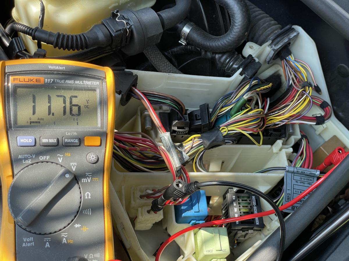

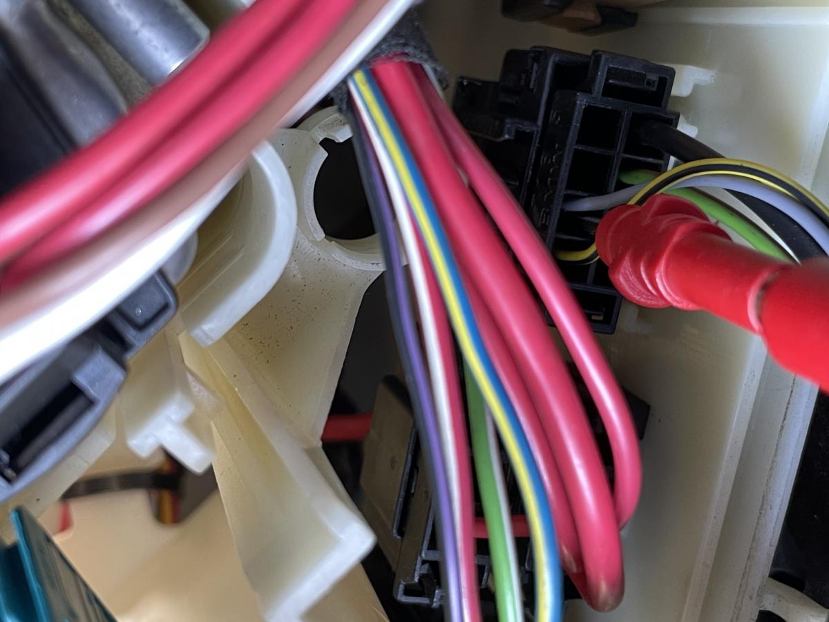

                              You can test the components of the circuit independently with a meter without getting under the car or taking any of the interior apart. See below
                              Testing the clutch switch:
                              Go to your DME box. Connect one probe of your multimeter to X6011 pin 3 (gray wire pictured below).
                              Click image for larger version  Name:	IMG_3672.jpg Views:	0 Size:	101.4 KB ID:	225278
                              Connect the other probe to ground (any ground point will suffice). Put the meter in DC voltage mode. With the key in position two (engine off or on), you should see ~12v on the meter with the clutch up, 0v with the clutch depressed.
                              Click image for larger version  Name:	IMG_3674.jpg Views:	0 Size:	162.4 KB ID:	225279​​
                              If you get constant 12v, the switch is bad. If you get no voltage, then either the switch is bad or you have a non-M switch (the non-M switch switches between open and ground instead of open and 12v).

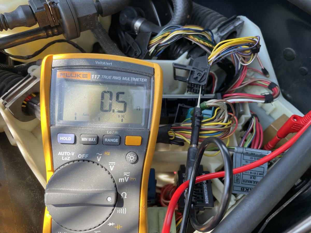

                              Testing the gear position sensor.
                              Take key out of the car. Set the meter to continuity / resistance mode. Leave the probe in X6001 pin 3 where it was. Move the other probe to X60002 Pin 20 (pictured below). With the gear lever in gear, you should see near 0 ohms. With the lever in neutral, there should be no continuity..
                              Click image for larger version  Name:	IMG_3671.jpg Views:	0 Size:	146.9 KB ID:	225280​
                              If the continuity does not change with the gear lever position, then that means this switch is bad. Either replace it or bypass it and code it out.
