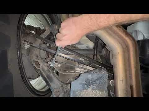

                    Folks, I think I found the source, but I'm confused WHY it's the source.
                    I put the car on ramps and did some 'push/pull' on the rear sway bar to rock the car, and heard my creaks coming from the REAR LOWER CONTROL ARMS. Both of them. I did the push/pull with my hand on the control arm, i could 'feel' the creak when it happened. I also tapped it with a socket and the tone it produced matches that of the creak.
                    There's nothing obviously wrong with them - the inner bushings look brand new (I think it had Turner ones on before I bought it, and the previous owner switched back to OEM for the sale). Any idea why this would create a creak?
                    I don't mind re-buying aftermarket ones, or just some new Lemforder units to swap in - but this one's a bit of a puzzler.
                      All bolts tight? I recently had the LCA to subframe bolts come loose on my car. To torque them back up you'll need to modify a socket: https://nam3forum.com/forums/forum/m...847#post210847
                        It sure seems that way. The inner bolt is just a regular old 18mm, I actually loosened it the other day and retightened it because I was afraid it was OVER tight. Outer bolts are also tight.
                        maybe the inner bushings aren’t seated right? Causing a creak when they move?
                          I went ahead and ordered Turner lower rear control arms, hopefully replacing that whole part will eliminate whatever is causing that creaking/popping. Has anyone seen this kind of noise from the control arms before? I'm puzzled as to why they're making that noise.
                            I don't think the LCA metal bar can make this noise by itself -- it's total insulated from the two rubber bushings. Something else must have hit it, or something hit something and not the LCA.
