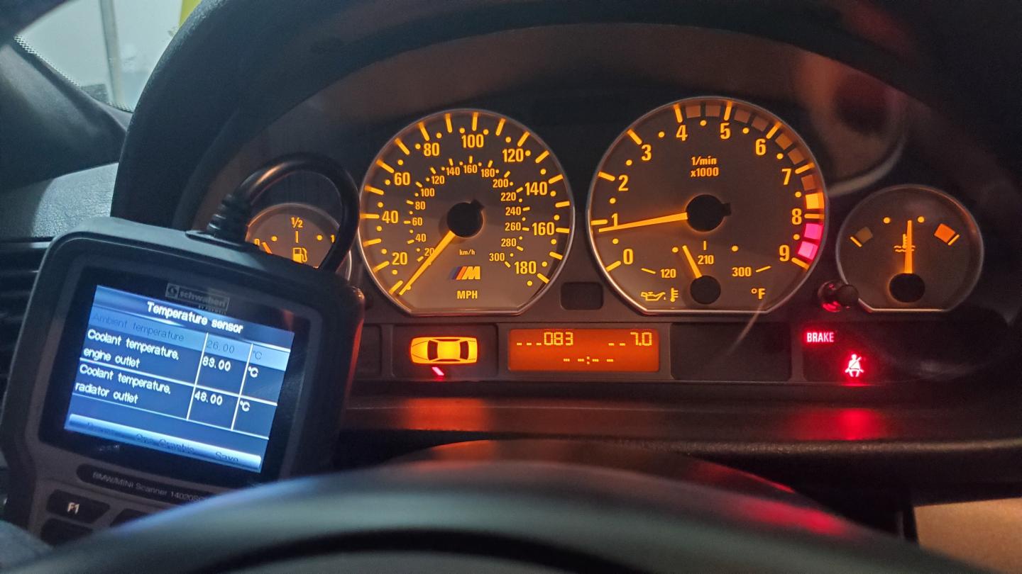

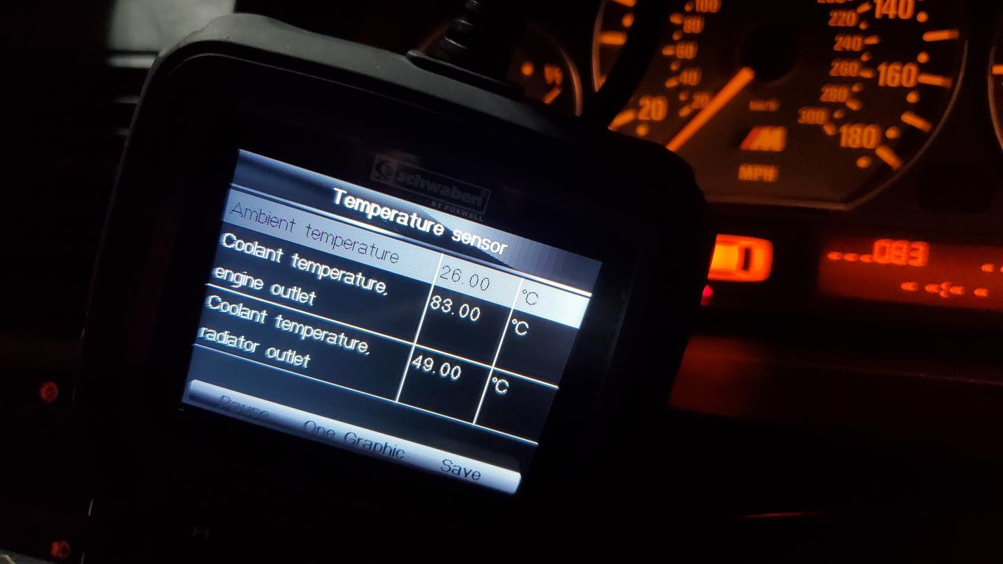

    Update. Reassembled the cooling system and got the engine up to operating temperature while sitting. The temperature gauge needle climbed to 12 o'clock and stayed put. I haven't driven the car, but everything appears to be functioning normally.

      Coolant temps look fine. monitor them when you drive too. Looks good.

        I would test it at idle with the A/C on to make sure it doesn't creep up.
