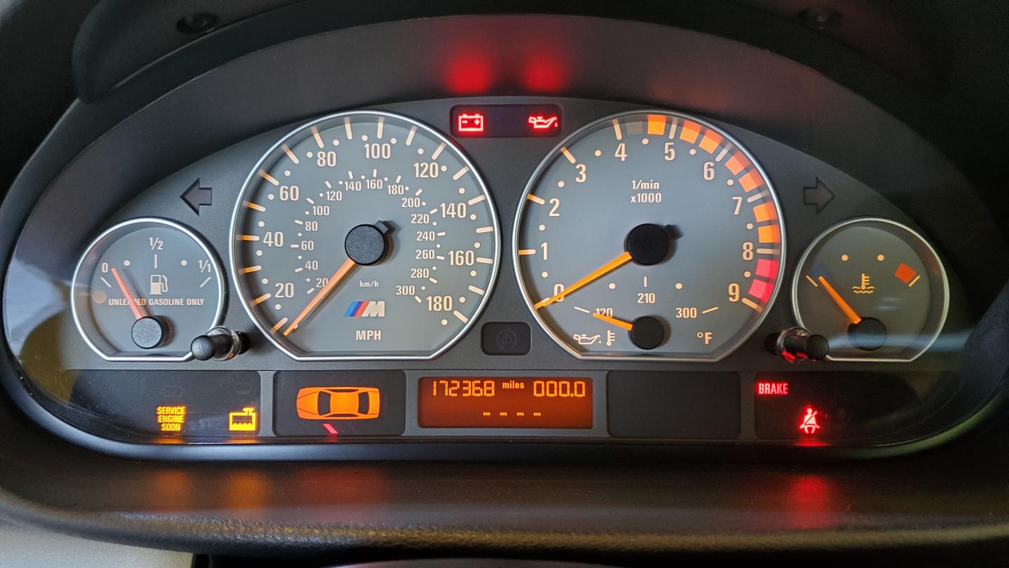

      Update. I finally had a chance to get back to diagnosing things. Last week I turned the cover, let it run for a few minutes, and saw the coolant gauge needle climb into the red zone again. The upper coolant hose warmed up, while the lower coolant hose stayed cool to the touch, but I didn't let the car run long enough to get it up to temp due to the needle position.

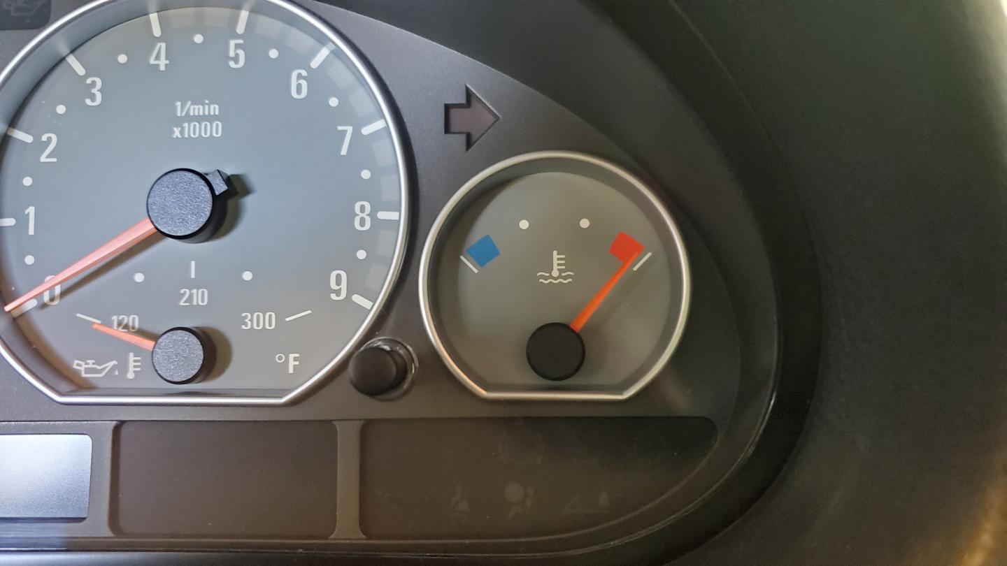

        I haven't turned the car over in a week. The needle is still pegging outside the red zone (see pic).

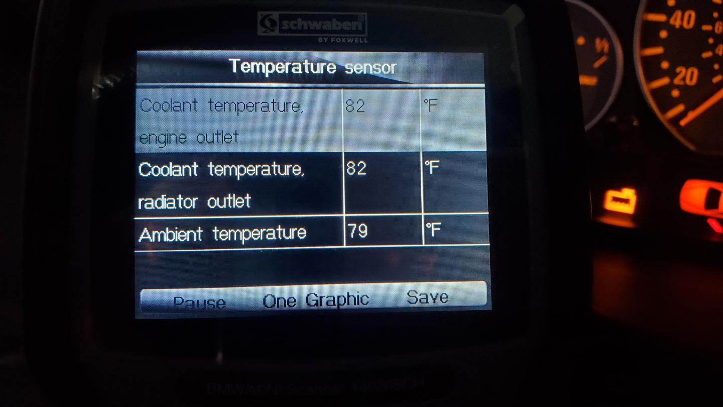

          Does it go into red immediately after you turn it on? If its immediate might just be a sensor issue. Have you logged inlet and outlet temps?
          With the engine running but still cold do you see coolant flowing into the reservoir from the overflow line? This should indicate that coolant is at least flowing…

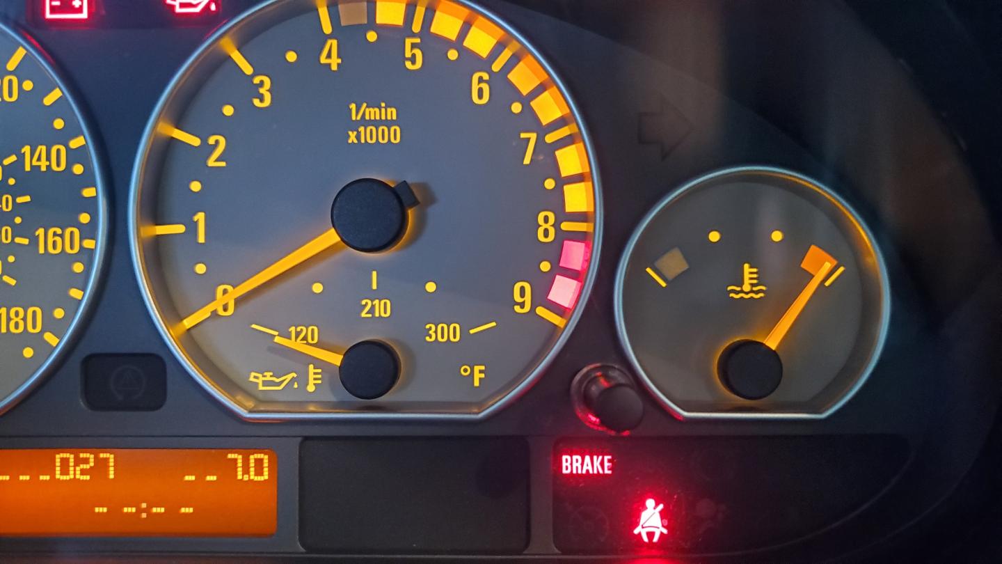

          It's immediate. It's actually consistently reading near red/in red. Problem with the gauge itself?
          Pulled temps. All seems fine.

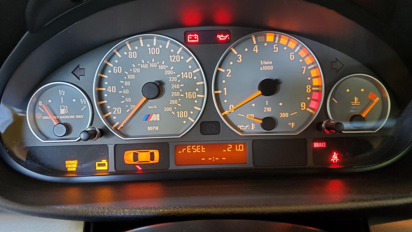

                      Did a gauge cluster reset. That seems to have solved the needle sticking in the red zone issue for now. Thanks, 0-60motorsports.
