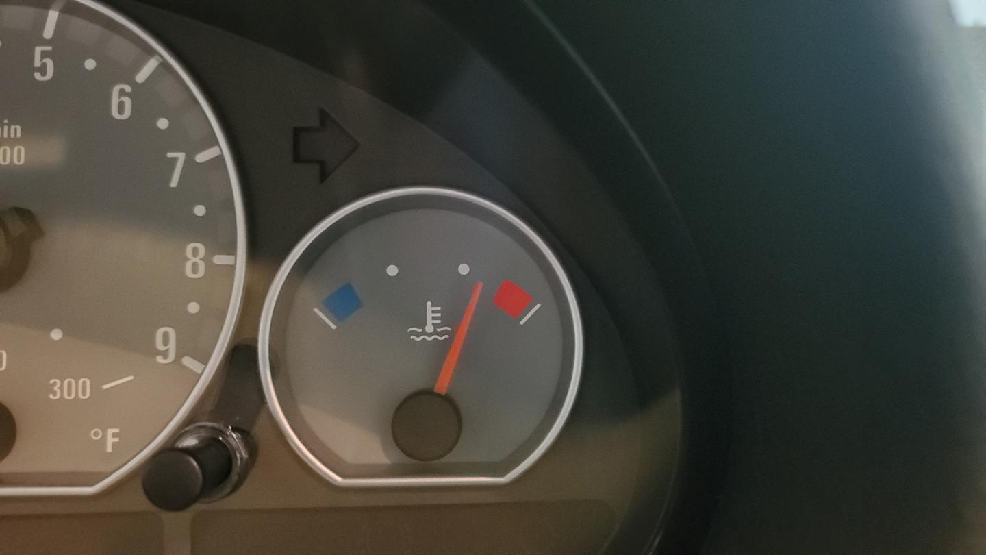

        Have you compared the needle position (red) to the digitally displayed temp?
        Why I ask: I’m confused looking at your picture. The oil temp is bottomed out (cold) and the engine is not running per the RPM gauge, so I haven’t sorted out if the ignition is on.
        (the temp gauge in the cluster can fail)
        I had the engine turned on per my original post, then shut it off when the coolant needle moved to red. The oil never reached operating temp hence the cooler oil temp. My next step is to perform to check the digital display when I get some time this week.

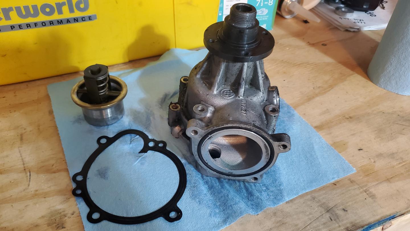

                              Thanks for the picture. Is the impeller composite or metal in this picture?
                              Can you share more context on the OE BMW water pump limited lifetime warranty? I'm not privy to this.
                              I think the impeller was composite, its been awhile. I know the OE pump I have on how is composite.

                                Update. I finally had a chance to get back to diagnosing things. Last week I turned the cover, let it run for a few minutes, and saw the coolant gauge needle climb into the red zone again. The upper coolant hose warmed up, while the lower coolant hose stayed cool to the touch, but I didn't let the car run long enough to get it up to temp due to the needle position.
                                I haven't turned the car over in a week. The needle is still pegging outside the red zone (see pic).

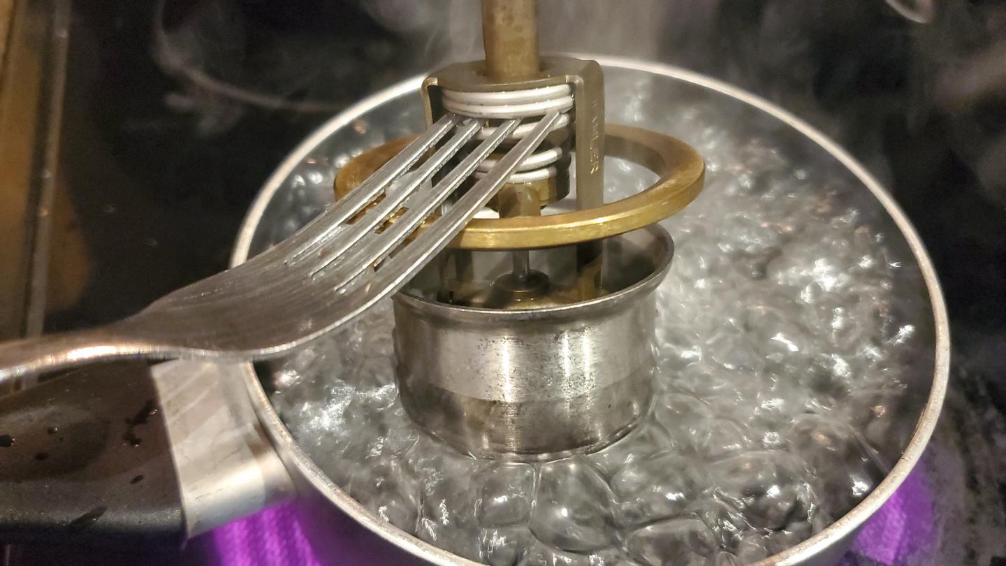

                                I decided to pull the thermostat and the water pump since I needed to perform a coolant flush. I checked the thermostat via the boiling water method, and it opened. I spun the water shaft and checked for play. There's practically no play, and it has resistance similar to new. This leads me to believe the hardware (at least the parts I've checked) are fine.
