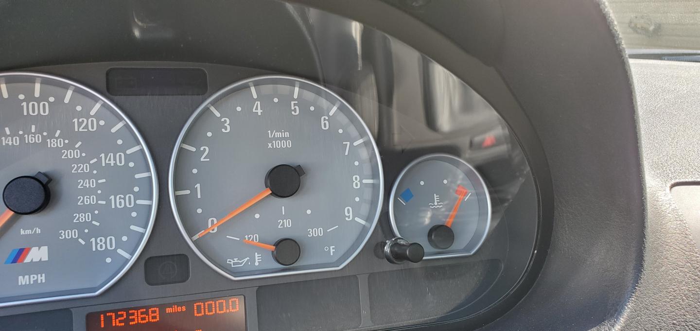

    Hi everyone,
    Today I pulled my M3 out of the garage to clean it up. I let the car run for a bit and noticed a grinding noise (like loose bearings spinning) from the engine bay. I used my stethoscope in an attempt to isolate the sound. I listened to all the pullies, etc. The water pump sounded fine on the top end. However, when I listened near the belt tensioner, I could hear a higher-than-normal frequency. When I climbed back into the cabin to shut off the car, I glanced at the gauges and noticed the temperature gauge needle was in the red zone. I shut the car off at that point.
    A few hours later, I checked the needle, which was still reading high (at the entry of the red zone). I hooked up my scanner to check for any codes but wasn't able to detect any. The water pump isn't leaking fluid, and I couldn't feel any play. Additional checks:

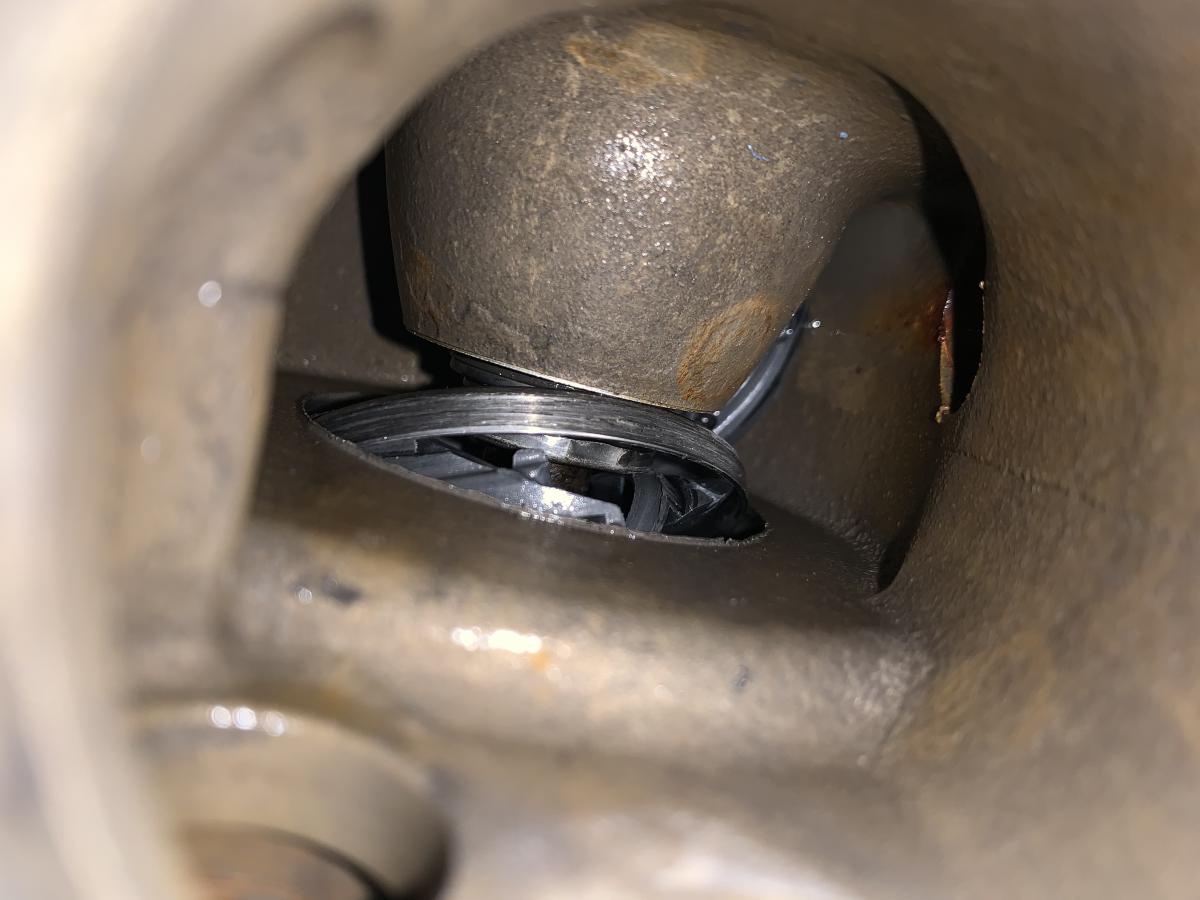

                  This is what my water pump looked like…water temps were running higher but not in the red and made no noises except for a chirp when starting up.
                  Pull the thermostat and check, relatively easy to get to.
                  Original BMW water pumps have a limited lifetime warranty.
                      Thanks for the picture. Is the impeller composite or metal in this picture?
                      Can you share more context on the OE BMW water pump limited lifetime warranty? I'm not privy to this.

                            Have you compared the needle position (red) to the digitally displayed temp?
                            Why I ask: I’m confused looking at your picture. The oil temp is bottomed out (cold) and the engine is not running per the RPM gauge, so I haven’t sorted out if the ignition is on.
                            (the temp gauge in the cluster can fail)
                              Why I ask: I'm confused looking at your picture. The oil temp is bottomed out (cold) and the engine is not running per the RPM gauge, so I haven't sorted out if the ignition is on.
