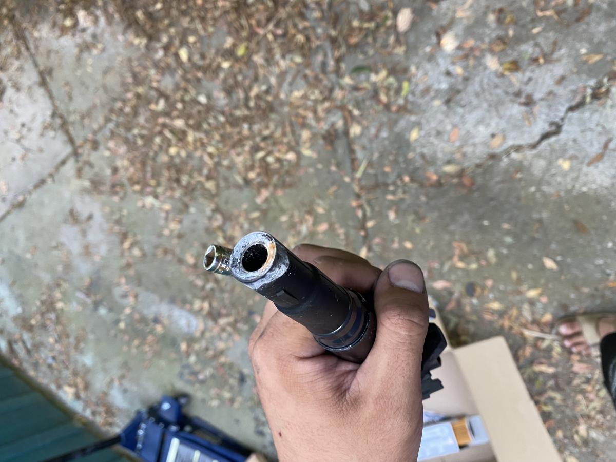

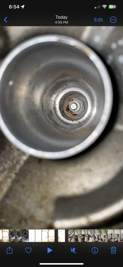

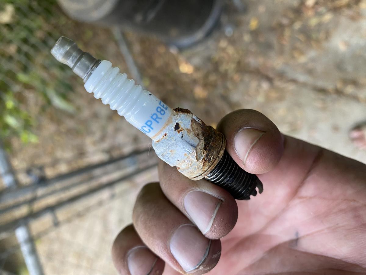

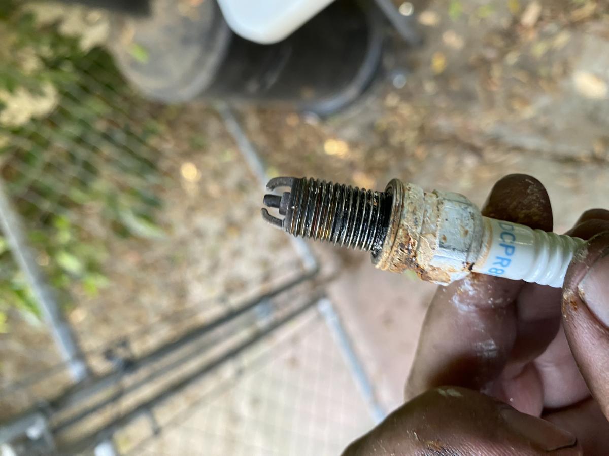

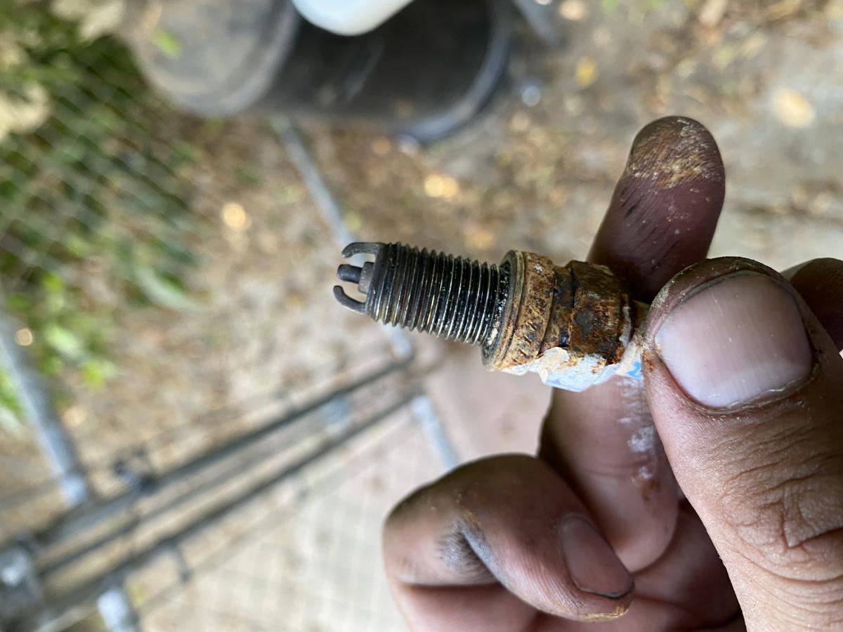

    Swapped out spark plugs and coils today, and everything was going great until I got to cylinder 5 -- a bunch of white and rusty residue at the bottom of the spark plug well and around the base of the spark plug. Plug has probably ~10k-15k miles on it. The actual electrode end that sits inside the cylinder looks fine, but I'm pretty worried about the rustyness -- looks like a lot of moisture got in there somehow. Is it possible that there's a way the headgasket could be leaking coolant into the sparkplug well? Photos below! All of the other plugs are fine. How worried should I be and what should I check? Car is running fine.
    You need to figure out what seal is leaking in your engine bay. The head gasket doesn't have anything to do with spark plugs. The bottoms are untouched from corrosion. Looking for dried water trails that lead to dripping in that spark plug tube. Also, replace that plug and coil at a minimum.
      You are probably just fine, perhaps some water sat in there for a while, just replace the plug and probably also the coil and check back in a while if it has happened again, probably not.
        Likely just some water/condensation that was sitting on top of the plug - did you wash your engine recently?

            Do you run with the black beauty cover on the valve cover? Not sure how water would get in the spark plug wells with the beauty cover on.

              Water pooled in the hole for sometime. I'm surprised that no engine misfired code during the time. Just clean up the parts and everything should be fine if they haven't broken yet. But you need to find how water got in there.

                            New question: is there a good way to remove the rusty residue/nastiness that is now sitting at the bottom of the sparkplug well? I assume I don't want any of that getting into the cylinder, so that seems tricky.
                              New question: is there a good way to remove the rusty residue/nastiness that is now sitting at the bottom of the sparkplug well? I assume I don't want any of that getting into the cylinder, so that seems tricky.​.
                              Well, I would find a short bolt, or cut one to length, with same threads as the plug and install the bolt with the plug sealing washer. This way you have the well full open to soak and clean up the aluminum corrosion.
