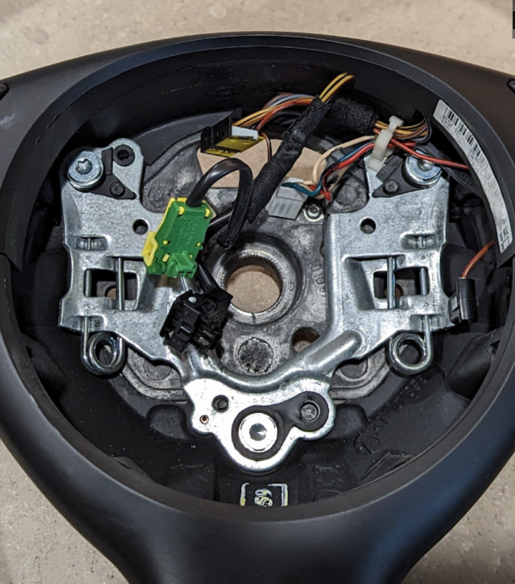

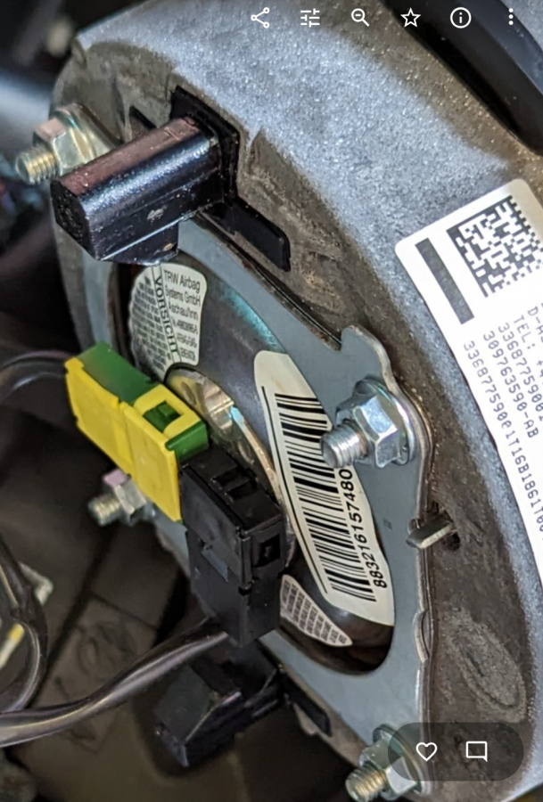

      Yeah when I did mine I don't remember it being that hard. Snapped in real easy. Here are some pictures of mine to at least compare something to when I had pulled it for some trim work. Also, what about the metal spring things inside the wheel? How do those look? I attached a picture so you can see mine, which didn't give me any issues. Perhaps one of those metal springy things is amiss? Wires getting the way a possibility too I guess.
            Thank you so much. These pictures were super helpful. There was one wire that was not positioned correctly which was getting in the way. I placed my wires same exact as yours and mine clicked in perfect. Really appreciated!
              You're welcome. I take a ton of pictures so I know how to put things back together as I take 'em apart!
