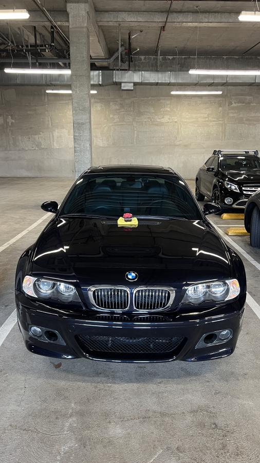

      Under the car cover, waiting for me to make a decision -
      Click image for larger version  Name:	IMG_0701.jpg Views:	0 Size:	141.5 KB ID:	258623

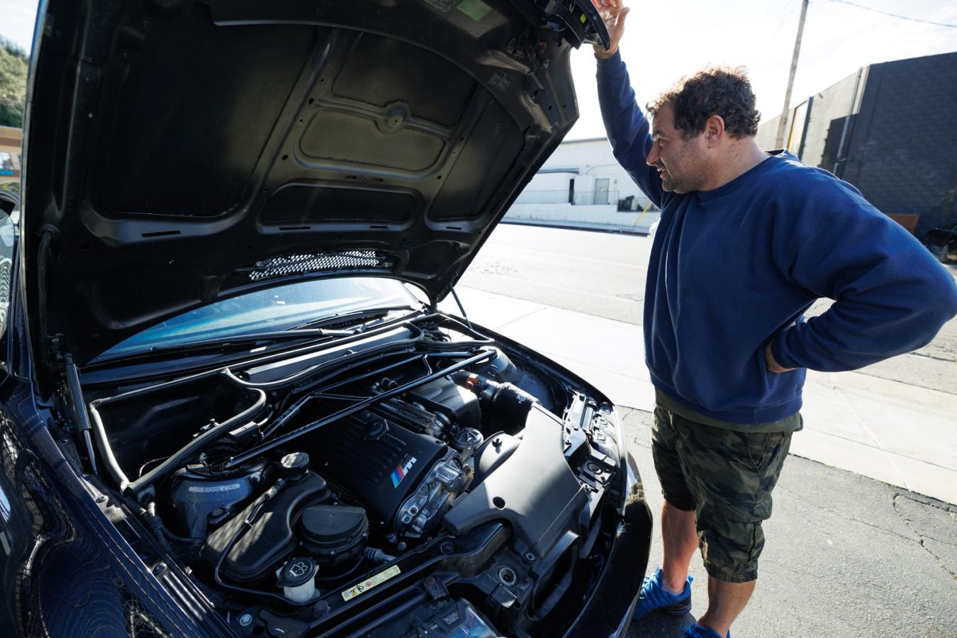

      It turns out that he’s an engine builder - Not just any engine builder who will work on the engine, but also the mechanic, and the machinist. This was a welcomed surprise, as he’s not outsourcing major components to some machine shop, but doing it himself so he will literally know the engine’s he builds inside and out.
      I also had no idea what a true fanatic he is about customizing BMW engines. When I visited his shop in Paso Robles, he told me he had developed a double vanos system for S38/S14 engine, I didn’t even know you could do that - I also saw pretty much every M engine that’s worth talking about being custom built in his shop: S38/S14, S65, a couple S54’s, an S62, etc. it was like heaven of BMW engines and experiments for new custom parts for these engines he was working on all over the place.
      I realized at that moment I had found a mad scientist for M engines.
      Also a fun fact I realized is that he’s big in the world of essentially every classic M car out there from the E24M6 E34M5, E30M3 S38/S14E46M3 E39M5 to the E92M3.
      We talked about pricing, how the build would go, what he would do, and how communication would go. He told me every single angle of what could be wrong with the engine based on my diagnosis and the symptoms that I was hearing - and matched that with what that might mean in terms of work, and pricing.
      He warned me that on a high-mileage engine when the head is removed and put back together there is a risk that the engine might start burning oil. This is because the bore shape will be changed at TDC. In addition to this, the existing piston rings will not take to the new shape unless they are replaced, and the bore is honed. This information no other shop cared to explain to me so that I understood what could occur and the risk I would be taking if I didn’t do the cylinders/rings at the same time. Ultimately the risk I would be taking if I only replaced the head gasket, is that once it’s time to put the engine back together I would most likely start burning oil. This is the kind of expertise I evaluated compared to the other shops who just wanted to R&R the head gasket and move on.
      Communication moving forward was simple: all messages and calls would be directly with him. No service person, automated service, or someone taking the calls. It would be him all the time. Pricing-wise we discussed prices in each direction I might want to go in to get the motor running again. He would provide photos of everything, and make sure I understood everything before proceeding or not, depending on what I chose to do.
      The experience I had with Anri from the initial conversations and visit was completely different than any of the other shops I spoke with. On top of all of that, he offered a warranty with the build: 2 years and unlimited miles, which was exactly what I was looking for. Yes, 2 years and unlimited miles is incredible, no doubt, but beyond that I immediately felt a sense of relief that finally, I have found a guy that stands behind his work. I mean BMW gives you 2 years or 40k. Now I found a guy who told me to go drive it across the country and hit the track, if his engine gave up, he’d honor it.
      After talking with him a few more times after this, and continuing to read his threads on this forum, I decided to trust him and go with his service for my engine.
      Click image for larger version  Name:	596A7682.jpg Views:	0 Size:	118.3 KB ID:	258624

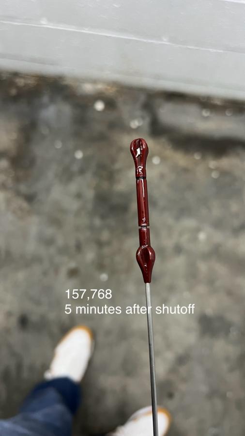

                                After about 1700 miles the oil is spot on where we filled it last and hasn't lost any oil in the meantime - this was before the road trip. I checked it mid-road trip and it was the same but didn't get a photo of it. When I take the car out in the next days I'll grab another shot now after it's got 3500 miles on it now. I always hear that rebuilt engines start losing oil pretty quickly after being rebuilt but hey mine hasn't moved at all since it was done, super happy about that - it never lost oil from the factory, and it's not losing any now
