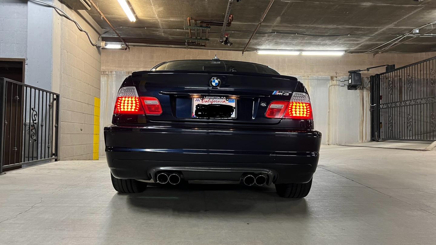

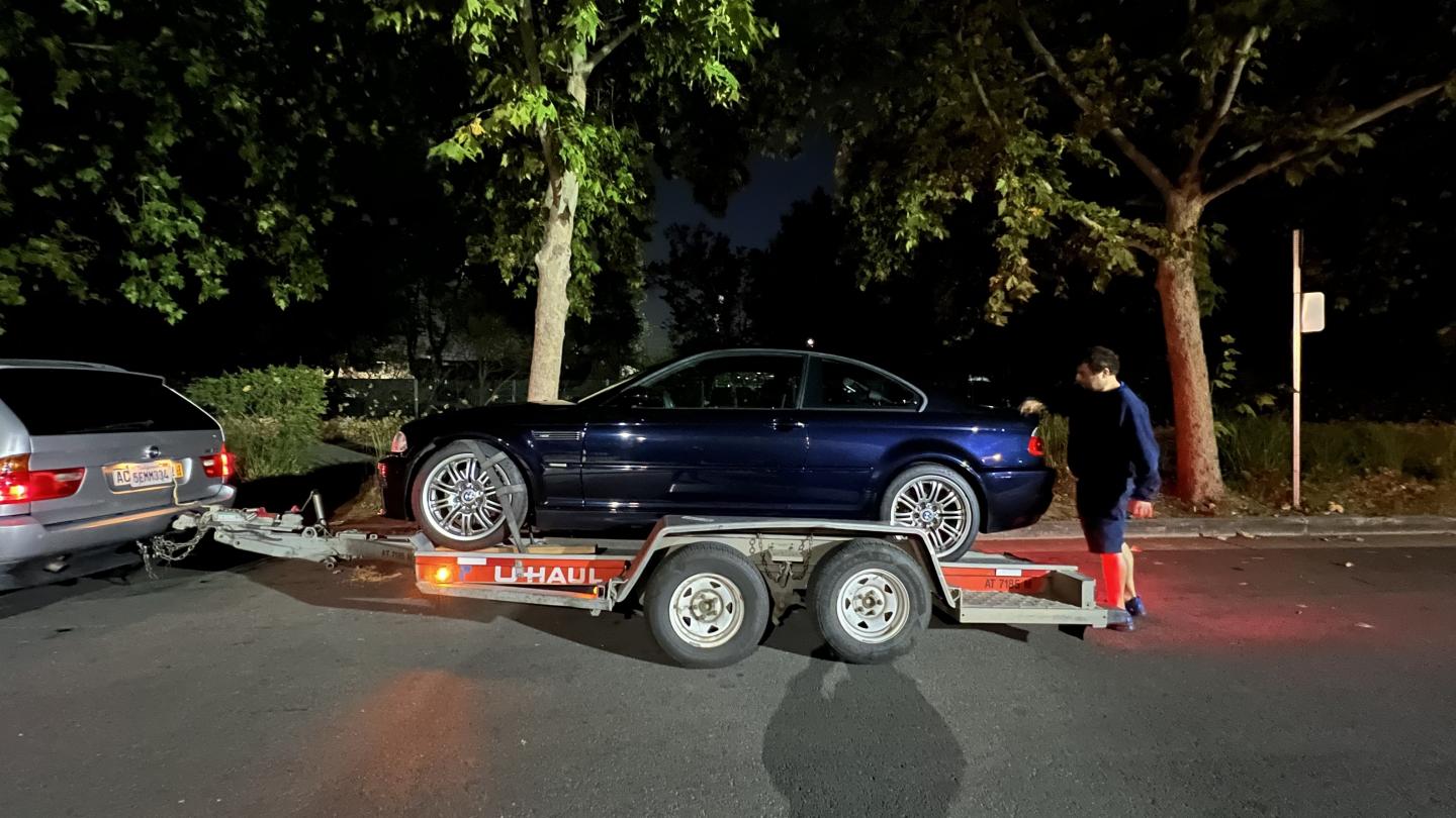

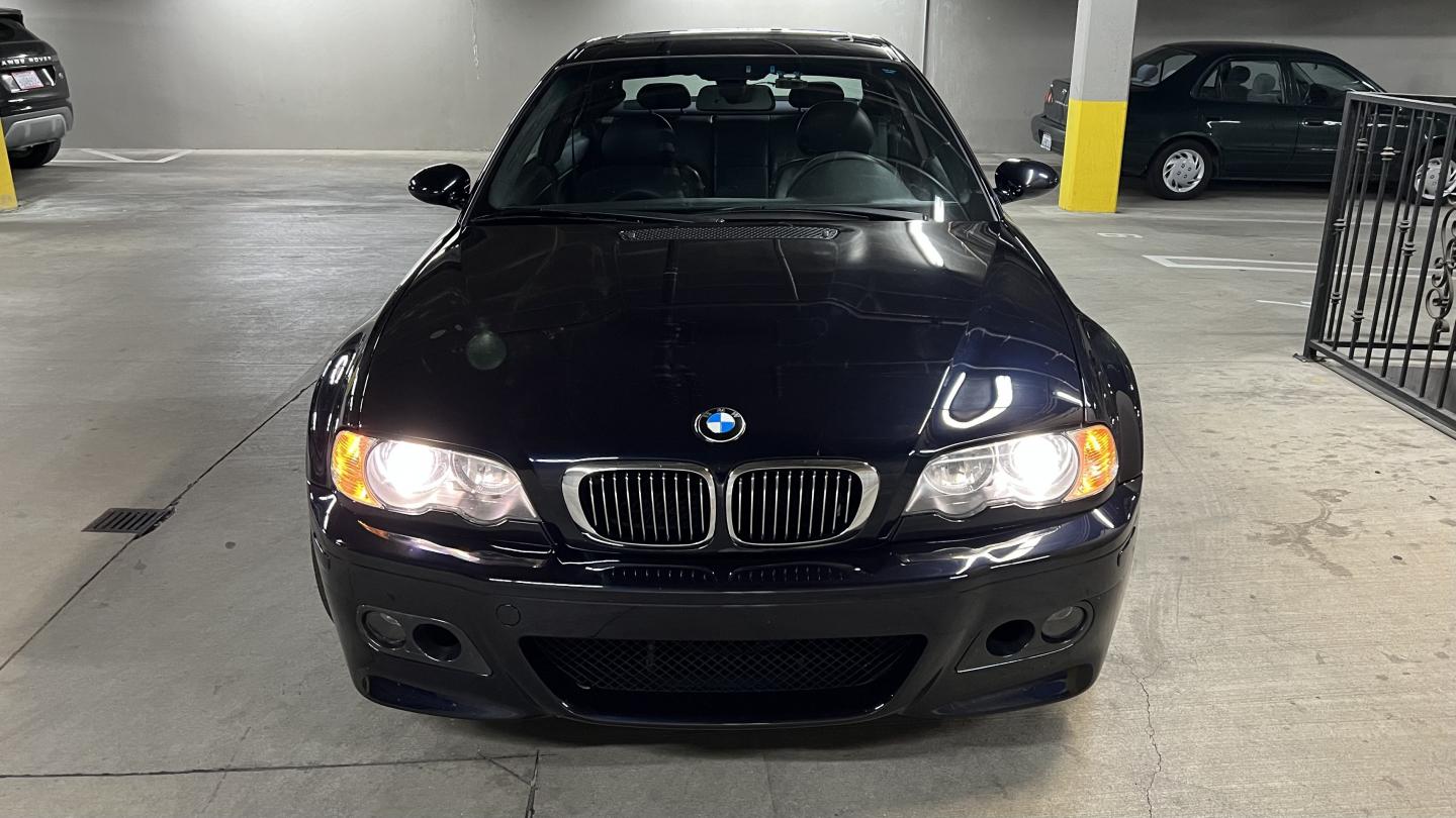

              11.20.23 - Update - Car was picked up tonight!!
              After some timing setbacks for pickup, Anri came to pick up the car tonight - It was great to meet him and he felt like an old friend of mine haha - So excited to see it loaded up and on its way.
              Plan is the following -
              Step 1 is to see what's going on in the motor, double-check the compression and do another leak down
              Step 2 will of course be the conclusion of that test, and more than likely the start of the tear down of the engine.
              Edit: I wanted to add some things that I noticed about the car that might help others trying to diagnose their head gasket -
              - The car started right up after sitting for 3 months, no smoke, nothing, just as it would usually
              - Regular driving felt totally fine
              - While getting onto the highway on an on-ramp, I heard a single ping noise in second gear and third gear, come from the engine while Anri was in the car. One could say this could sound like a single marble hitting the inside of a tin can. He flagged that as a sign of the HG and the sharing compression in each cylinder potentially causing a single detention. I had never heard this before prior to this drive and thought to add it. As Anri has mentioned to me it's really good that I caught it this early without it getting any worse, and this is a clear other symptom of what most likely is a blown head gasket,
              More to come as I have updates!
