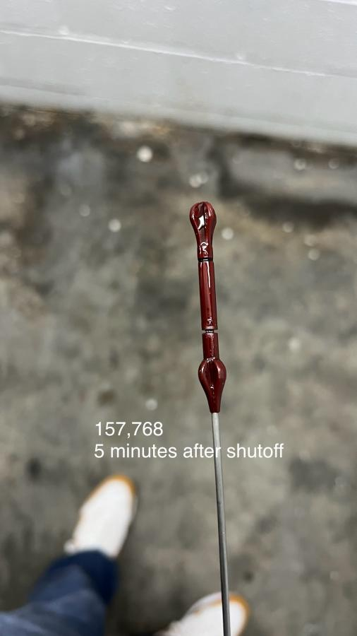

    Well, you get more oil in the pan holding the stick upside down.

      sapote - Sorry not following you on that one, in the photo I'm holding it horizontally, what are you inferring?
          Pic shows a vertical stick. Is it me only see it vertical with the texts in normal horizontal?
          No noticeable oil consumption after 1700 miles is a very good news, and Anri had done a very nice job on the engine.

            Is he standing on a wall?
              Gotcha - with my shoes on the floor, the stick is horizontal to the ground
              But yes! No consumption so far, I'll be reporting it as time goes on with mileage as well

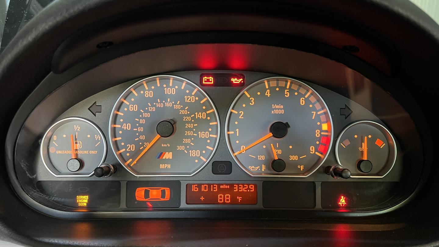

                UPDATE - First oil change after I drove the car 5,000 miles -
                This past Sunday Anri and I met up to get the first oil change done on the car after I put 5k miles on the car since the initial break-in oil.
                Here's what happened / work was completed -
                - NO oil has burned in the car, which I know has been a thing for other built engines - So happy to report that my motor is exactly as I like it, no added oil between oil changes.

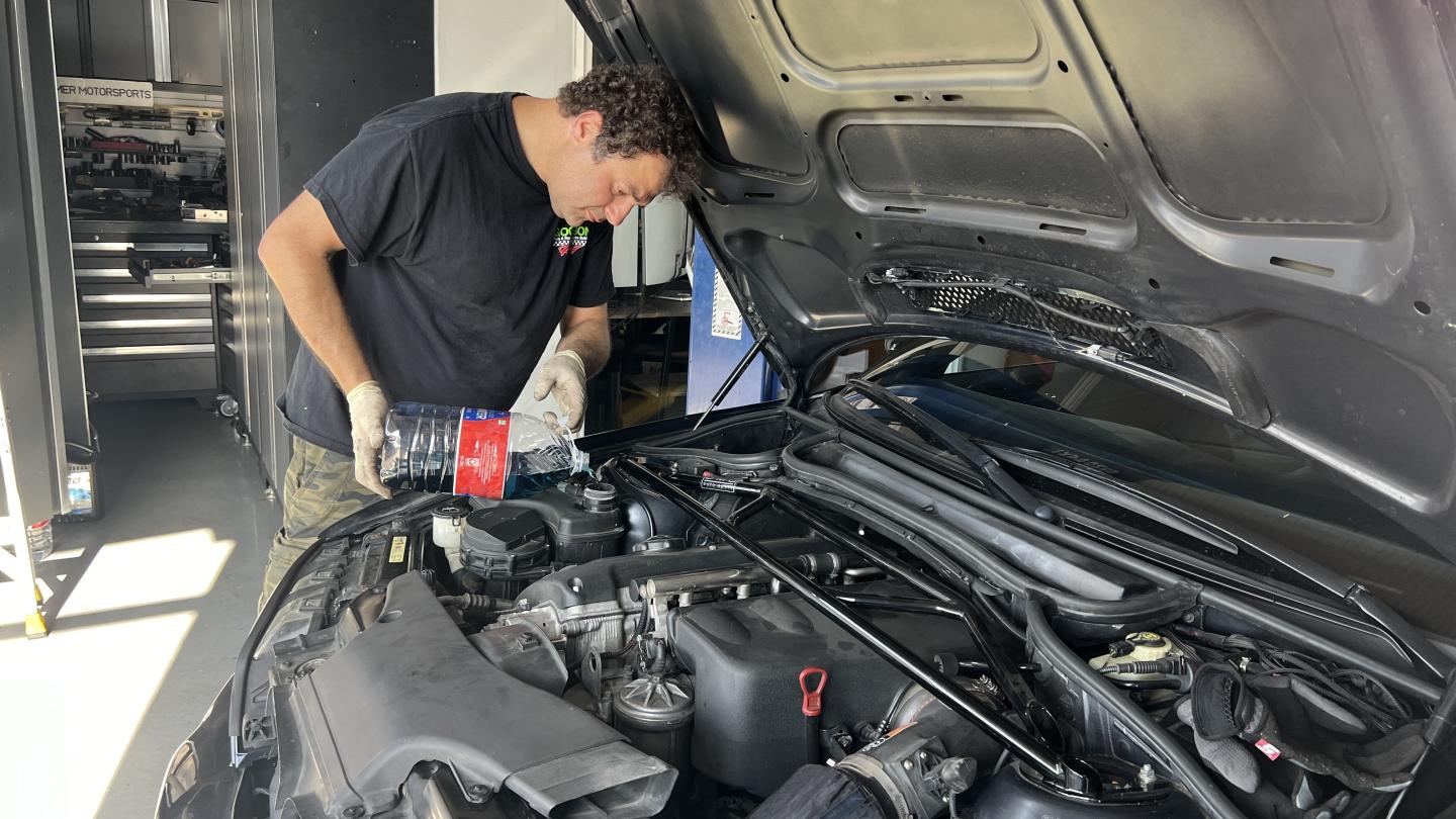

                - Anri also installed his new concept: a 70-degree C thermostat, to prevent the engine from getting heat-soaked
                - Works fantastic - with the Sachs fan clutch you can hear with the windows closed with A/C on
                - The Bimmerworld braided brake lines I had installed in the front were unfortunately rubbing so much so that the braided line had a hole in it, luckily the rubber was fine, but these were replaced with a fresh set from Bimmerworld which featured a new grommet that they developed which fits now perfectly in the stock holster for the line
                - I took a sample of the oil for Blackstone and shipped it out, so I'll post those results when I receive it back
                Now the car runs in the temperature range that is optimum for engine performance before the engine is heat-soaked. Before with the stock setup, I would actually feel this heat soak happen around 90-93 C degrees which I thought was normal and now with this new setup, that feeling never hits anymore. I swear that the torque curve is different now.
                Results so far -
                - The new 70-degree thermostat is incredible. In 105 F degree heat with the A/C blasting, the car is sitting cooly at 83 C degrees at maximum in bumper-to-bumper traffic, and 78 C degrees while driving. Compare that to the factory thermostat with the Bear fan clutch, and the car was at 90-93 C degrees. The low-end torque is seat-of-the-pants noticeably different, I feel like the car has a new torque curve now which is quite impressive considering that is the only thing we changed on the car. I haven't been able to get it in the canyons yet but will hopefully this weekend and will post about that as well
                - Clearly the front braided brake lines were gone as the brake pedal feels completely solid now, so taken aback by that and thankful we did them now. I replaced the stock rubber ones in 2019 with these braided lines, and yeah in 5 years they were worn
                More to come as I drive the car but so far, so good!
                161,013 - 5k after we did the initial break-in

                Anri filling the coolant after doing the thermostat

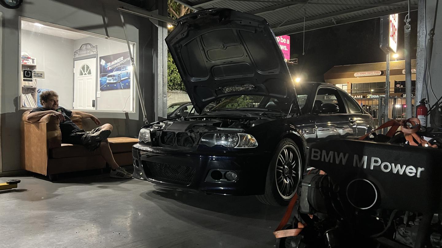

                Anri and his friend's GT3 that stopped by to help diagnose what happened after it just threw a check engine light

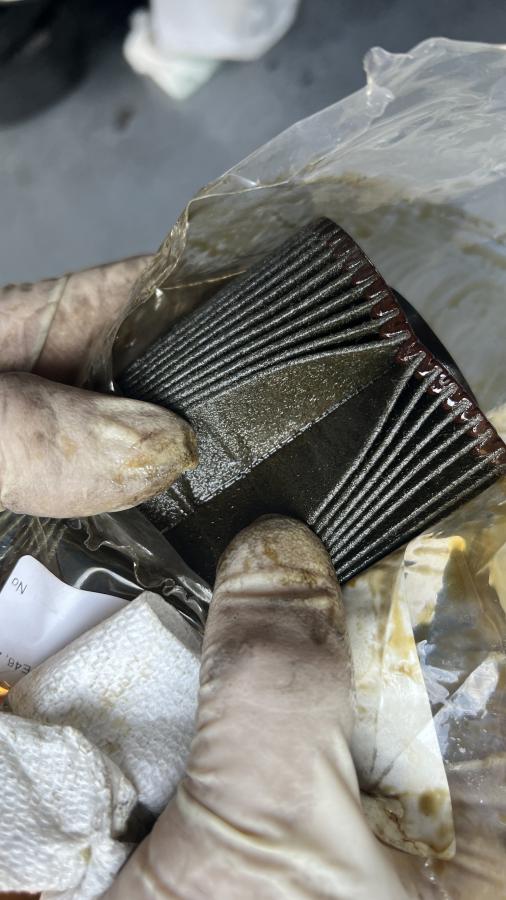

                Oil filter after 5k - no metal shavings or anything!

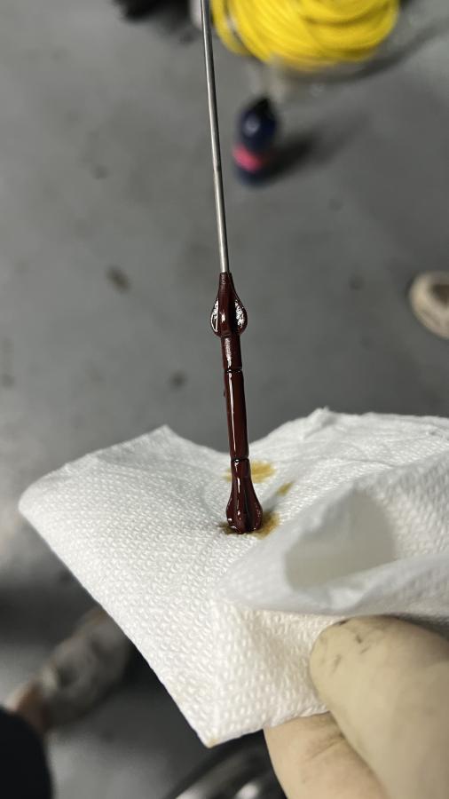

                Dipstick after fresh oil
