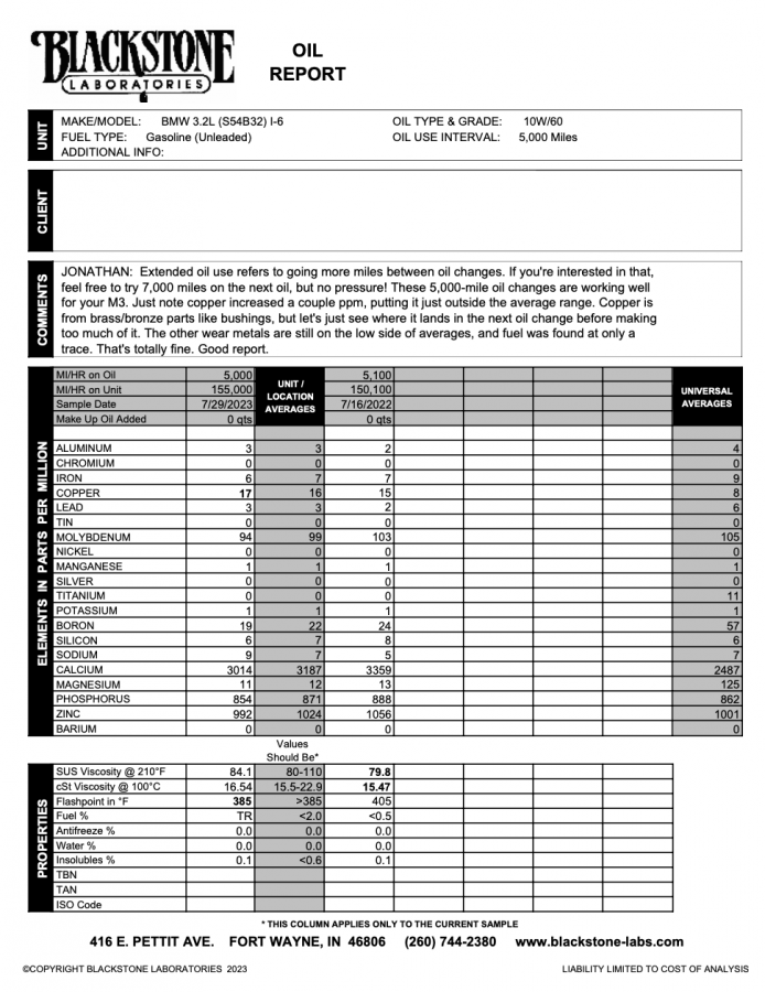

                Also attached, which again, I find so bizarre with this information now - is the Blackstone lab report from the last 10k. I called them when they sent it and spoke with the guy who analyzed the oil. He said there were zero indications of a head gasket failure or premature wear in the oil in the last 10k. Maybe I caught it that quickly? I would think that the oil report would have shown it way sooner than audibly hearing a faint misfire, but I'm clearly wrong. Just thought to mention.

                • No indication from Blackstone Labs reports in the last 10k of HG failure (as they would have detected metals, coolant, remnants of coolant, in the oil)
