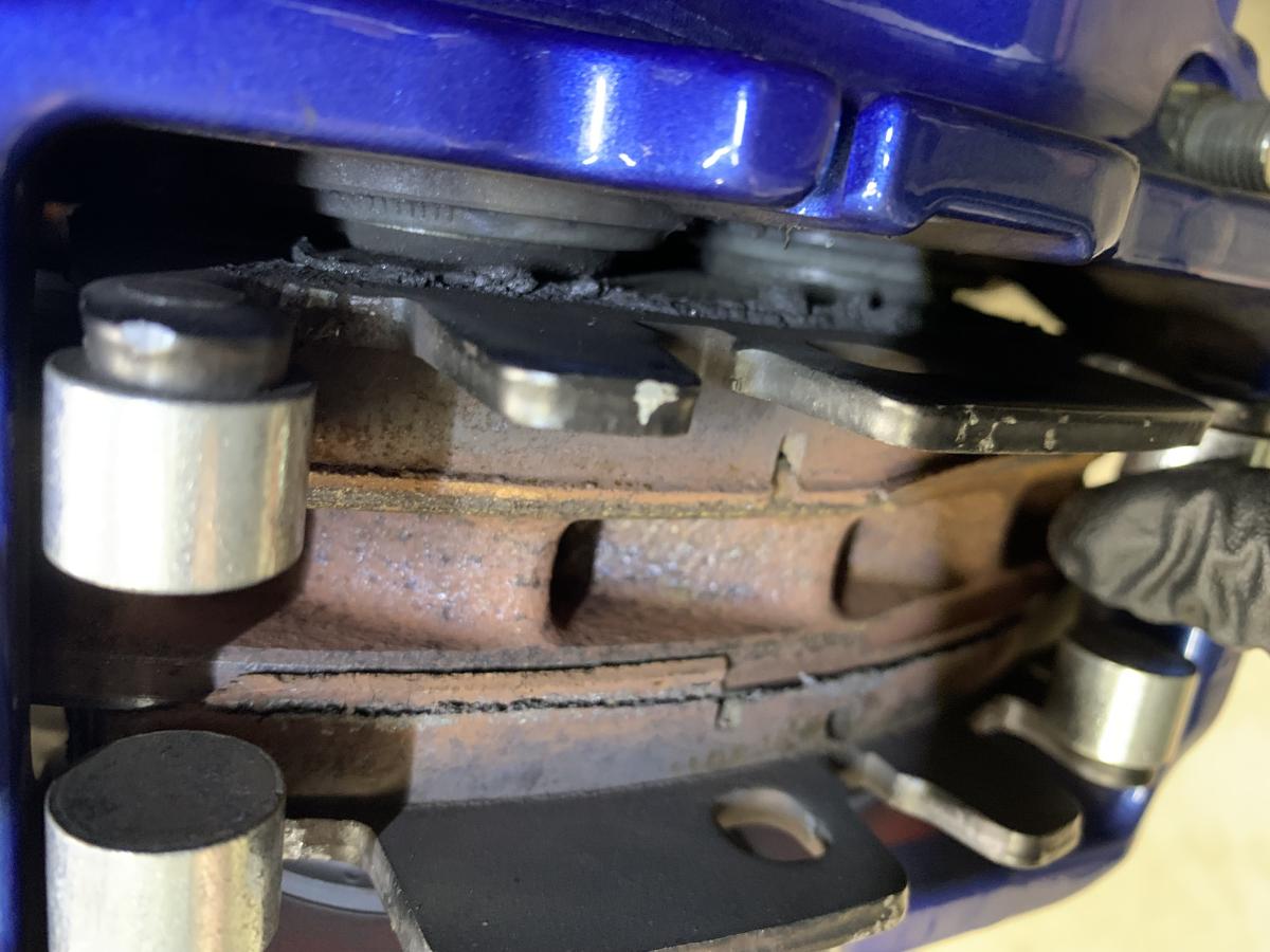

            First ever track day. It seems I was not terribly hard on the brakes as my plain-Jane Centric dust boots held up.
            This is the fist time I have noticed that the pads are a bit too tall and extend just a bit above the top edge of the rotors. They do fit nicely at the bottom. Is this to be expected?

              Centric made the parts for stoptech and in 95% of the applications I recommended them. You have tons of pad which in itself is a nice thermal barrier. I would take out the pads, clean them up, and put them back in. But overall I wouldn't loose any sleep over that!
                What street pads were you running?

                  [QUOTE=D-O;n276867
                  This is the fist time I have noticed that the pads are a bit too tall and extend just a bit above the top edge of the rotors. They do fit nicely at the bottom. Is this to be expected?[/QUOTE]
                  Yes, once you get seriously moving and put enough heat in, the rings will expand radially and grind that off.
                  That said, at slower pace, you don't need to do anything with that edge, it will crumble away naturally, so you don't need to take anything out to clean.
                    Hawk ceramic. I am not crazy about them. At the time the car was my daily, and I bought them in the hope that they would be clean. They have not let me down on that.
