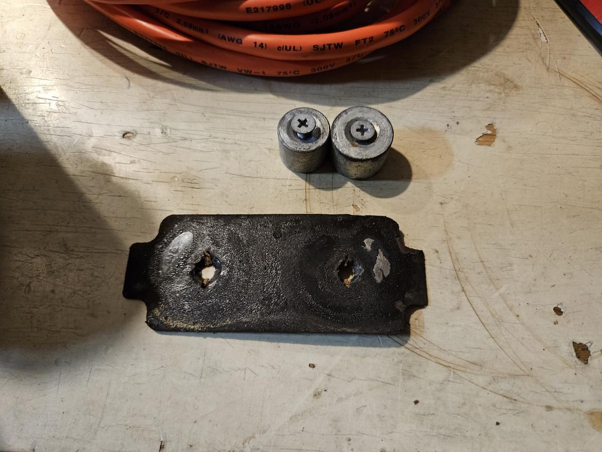

                Was just talking to some local people about heat management with these calipers the other day. The stock noise isolators that stick to the pads are made of what appears to be steel with a rubber coating. Bry5on ran the math and found that a heat shield made of 0.1mm elastomer and 1mm steel would result in the same thermal conductivity as 1mm of titanium. Any thicker on the elastomer and it outperforms Ti.
                Point of this is that the calipers are designed to have those isolators installed. Heat getting to the dust boots is probably much higher without them. The problem is likely extra bad with track pads, as most of them have a backing plate made of just steel and lack that HDPE-like layer that street pads like textars have on them. I know that layer is probably mostly on there for noise, but it should make a pretty big difference regarding heat transfer as well.
                My plan is to use the OE Porsche/Brembo dust boots and a heat shield. Haven't decided yet if I want to run the titanium shims or the stock Porsche ones with the metal cylinders removed (pic below). Will likely buy the Ti stuff and run a quick experiment to see which one does a better job at track temps.
                I know this didn't answer your question, but I figured I'd share, as less heat there should help prolong the life of the seals.

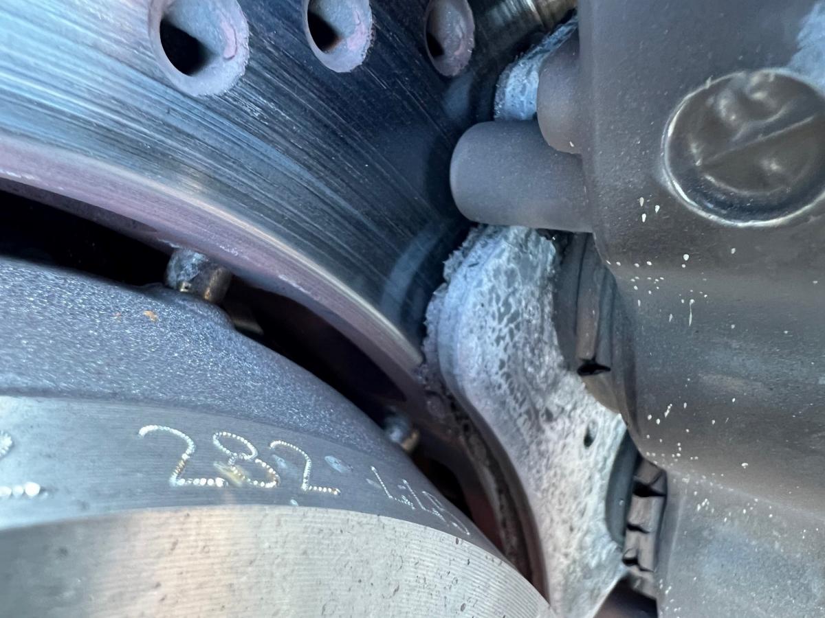

                              Calipers seizing up from crap in them is no joke-- this really took center stage for me at this moment because a friend of mine had a front 996 caliper seize up on him last weekend on track, at ~130mph:
                              Could have gone worse
                              ... I'd still like to keep crap out of mine, which means dust seals.
