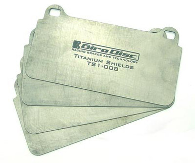

Just my gut feel says there is something to that. The thickness and mass of the new brake pads creates a thermal barrier for the caliper and boots. Do folks use titanium heat shields as well? Like these:
Yes I run 1mm hardbrakes.com version, but girodisc makes their own version.
To reiterate, I run 1mm (believe thickest they make) Ti shims with Vorshlag cooling deflectors (which move more air than hoses) and still have issues with dust boots.
