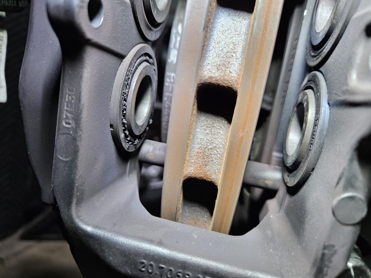

    Brembo dust boots did not survive a track day . Granted, this track day was extra long, so the brakes got a good workout. 7, 30 min sessions vs the regular 5, 20 min sessions.
    Setup was 996 calipers, ZCP rotors, PFC08 pads, titanium shims and brake ducts (which are kinda useless with the new rotors). Even with the cooling/heat shielding, this still happened:
    That was the only boot that fully failed, but I found a few others that were a bit melted. Replaced with a girodisc one for the time being. I'll likely replace all of them before the next track day just to see how those hold up.

                  Update: High temp silicon seals held up!
                  (https://racingbrake.com/bp-404bs/)
                  Car was doing double duty, running in instructor and advanced group, back to back, all day. He was not running backing plates.
                  Disclaimers; 50-60 deg ambient and summit point raceway (not that hard on pads), so not WORST case scenario-- but I'm stoked. Will be installing this winter.

                          So I installed the RacingBrake seals from above, and it looks like I'm going to have the same issue mrgizmo04had here: https://nam3forum.com/forums/forum/m...511#post229511
                          The dust boots for the smaller piston don't have enough friction to stay in place. I plan on reaching out to RB about this, these weren't cheap!
                            #88
                            Don't remember if I posted this, but this is an issue with using Stoptech/Brembo/Girodisc dust boots on these 996 calipers. I don't know why, some bore spec is off somewhere. Several kits from Brembo and several kits from Girodisc, still same issue. Stoptech boots in Stoptech calipers no problem, Brembo boots in Brembo (GT kits not these 996) calipers no problem. The way I "solved" the issue is I squeeze deliberately yet gently on the outer metal ring of the dust boot to slightly deform it to make it oblong/oval (very slight). And it seems to stay in.
                            🤷‍♂️ I'll live with it with that slight workaround.

                                Im in the same boat but with Renault Megane Brembos (Freakyparts kit). Melted the stock new dustboots with 16mm GLOC pads and only slightly worn ZCP rotors, since the pistons had to be fully compressed to fit them and was only able to put Ti heatshields on outboard side. I then replaced the inboard boots (which were completely melted vs the outboards) w the RB blue high temps, and put 14.5mm PFC pads and new Girodisc rotors (no heatshields this time). While better, 3 of the 4 RB high temps had developed cracks next track day… I mean it’s def from direct contact to the pad backing plates but still frustrating that even w a ‘thinner’ pad thickness they still touch n cook. I then installed new RB blues boots for the outboards along with the Ti heatshields both sides hoping now they will survive without cracking next track day, but I’ll have to replace the already cracked inboards again. This will get tiresome and expensive if I have to keep replacing dustboots after every track event.
                                mrgizmo04 I was actually thinking the opposite, that as the pads for wear down in thickness with use maybe the dust boots will survive since won’t (shouldn’t) be touching the backing plates directly as much lol.
