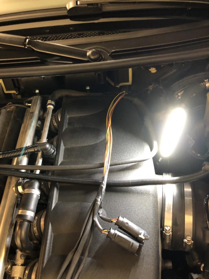

      Here is what you will be dealing with, before cutting the corrugated protection:
      Click image for larger version  Name:	Wire_Gromment_1.jpg Views:	0 Size:	90.7 KB ID:	229790​

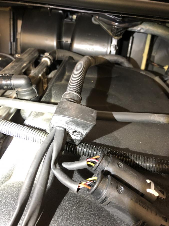

      Cut back to here:
      Click image for larger version  Name:	O2_Wiring_1.jpg Views:	0 Size:	64.3 KB ID:	229791​

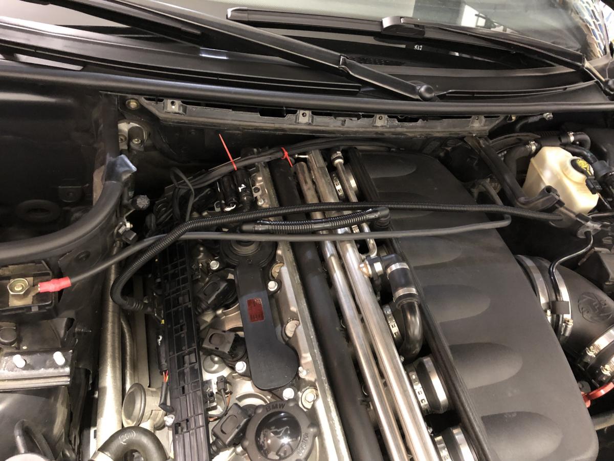

      Prepped for my installer...
      Click image for larger version  Name:	Prepped.jpg Views:	0 Size:	153.3 KB ID:	229795
