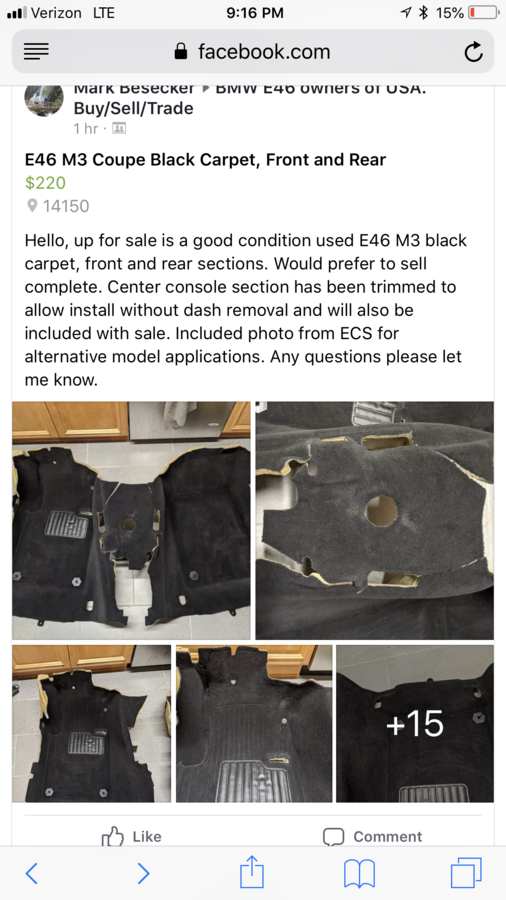

                    Found carpet for sale.
