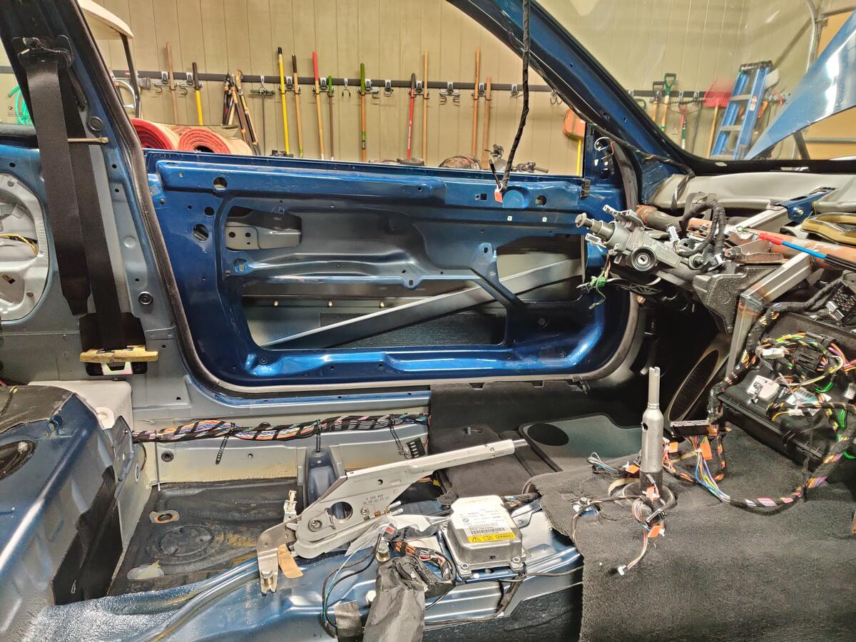

      I'm repainting my car, trying to get as much out of the way for the paint shop as possible. The car currently looks like the photos in THIS POST except the rear carpet is gone, as are side head airbags, and few other things.
      I'm trying to weigh, A. pulling the front section of the carpet in order to provide as much uninhibited access for the body shop as possible and reduce risk of them damaging the carpet unintentionally (overspray) against B. the complexity of the job and risk of introducing a rattle, breaking something or whatever. So my questions are:
      1. If the carpet is cut as show in liam821 's photos above, does that affect the carpet's ability to stay in place once you reinstall the carpet? It seems like cutting the carpet under the HVAC stack in the center of the dash (above the tranny) is a MUCH EASIER way to get the carpet out, but I'm worried that I'll run into sagging carpet down the road. I know the carpet has a bit of structure to it but... ?
      2. If it turns out cutting the carpet is a bad idea, what really has to be removed to pull the carpet? The HVAC and center dash support bars (the near-vertical bars framing the HVAC) I see have to come out for sure, but does the steering column have to come out as well?

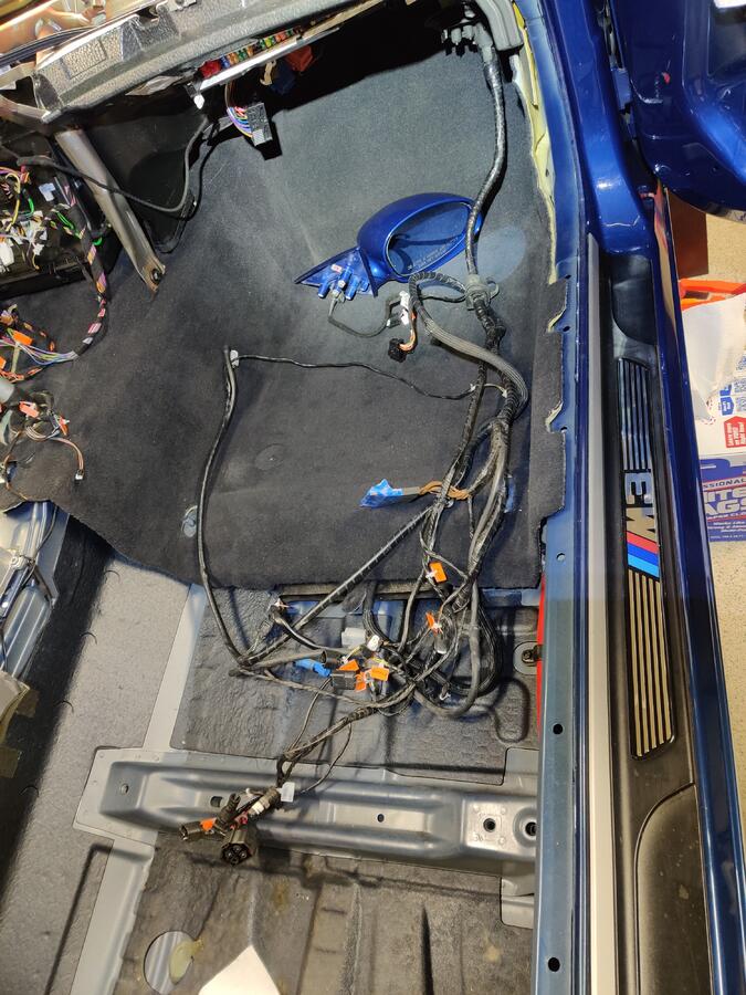

      Here is a better shot of the car at the moment. Rear carpet out:
      Engine bay wiring pulled back into the passenger compartment. You can see the carpet can be pulled away from the rocker panel here (for paint), but it's soooo close to having all of the carpet gone. Still, I'm not sure it's worth the extra effort or not.:

        I cut my carpet and no one would ever know, and I mean it is absolutely impossible for anyone to have any idea it has been cut. There are wires under the carpet so be very very careful.
          Casa de Mesa If you want some added rigidity, you can always "recombine" the carpet with the piece under the dash using some zip ties. Or even sew them back together.

            You convinced me!
            Will try the zip tie method. Carpet is coming out.

                    Yeah, it stays there cut like everybody else mentioned above. I wanted to change out my hvac system anyway so it was a no-brainer for me. But if you don't have to, I'd recommend against it since you have to drain the A/C system and it's a general pain.
                      Awesome, thank you. This is very helpful. The motor is coming out (hopefully this coming weekend) so coolant will be out of the motor, but even with that happening, I'm hesitant to dive into the HVAC given the complexity and risk associated with it. If it doesn't need to be done to achieve the result I'm looking for, no sense in overcomplicating things! Which I'm famous for
