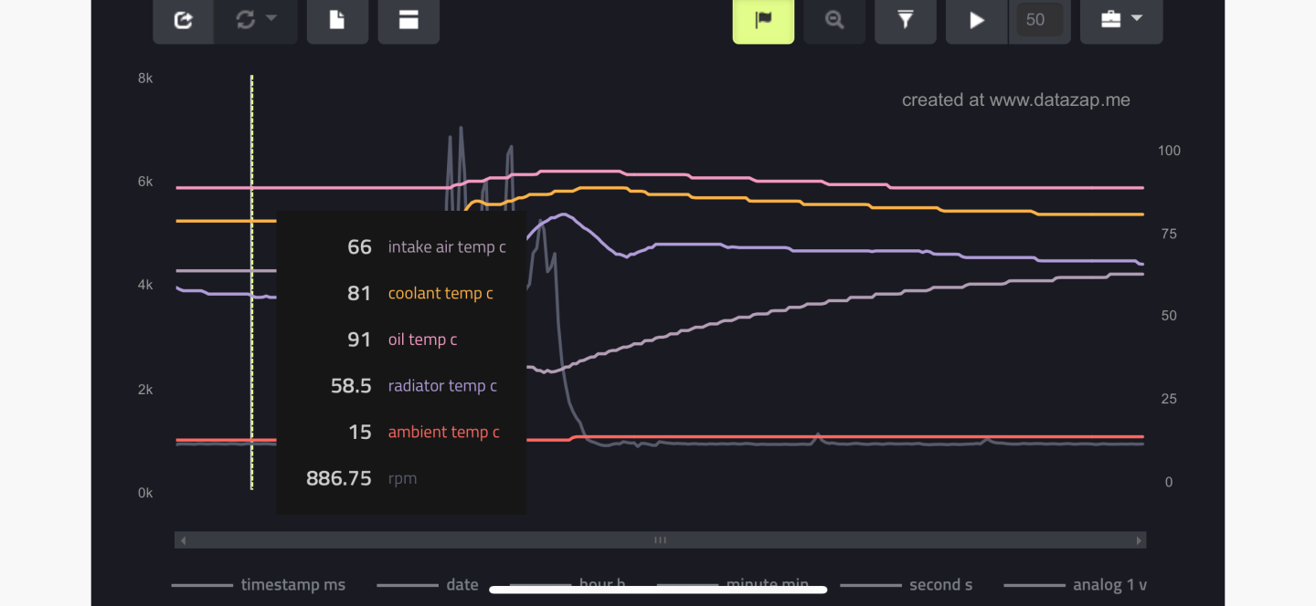

        Confirms what I wrote above if you ask me, your map likely has some issue that it can’t compensate for when combined with your long term fuel trims. This could actually be related to the non-idle parts of your map as the car learns from and adapts to your normal driving conditions. If you reset adaptations and the idle hunt goes away after a brief <5min short drive and ignition cycle (to essentially just reset cam adaptations), this would be one way to support that theory.
        I regularly see 60-70C IATs at heat soaked idle with my factory-like CSL setup, even with the valve closed and drawing air from behind the fog light. 70C certainly isn’t outside the realms of possibility at full operating temp idle with AC on. This was last weekend for me during an autocross:

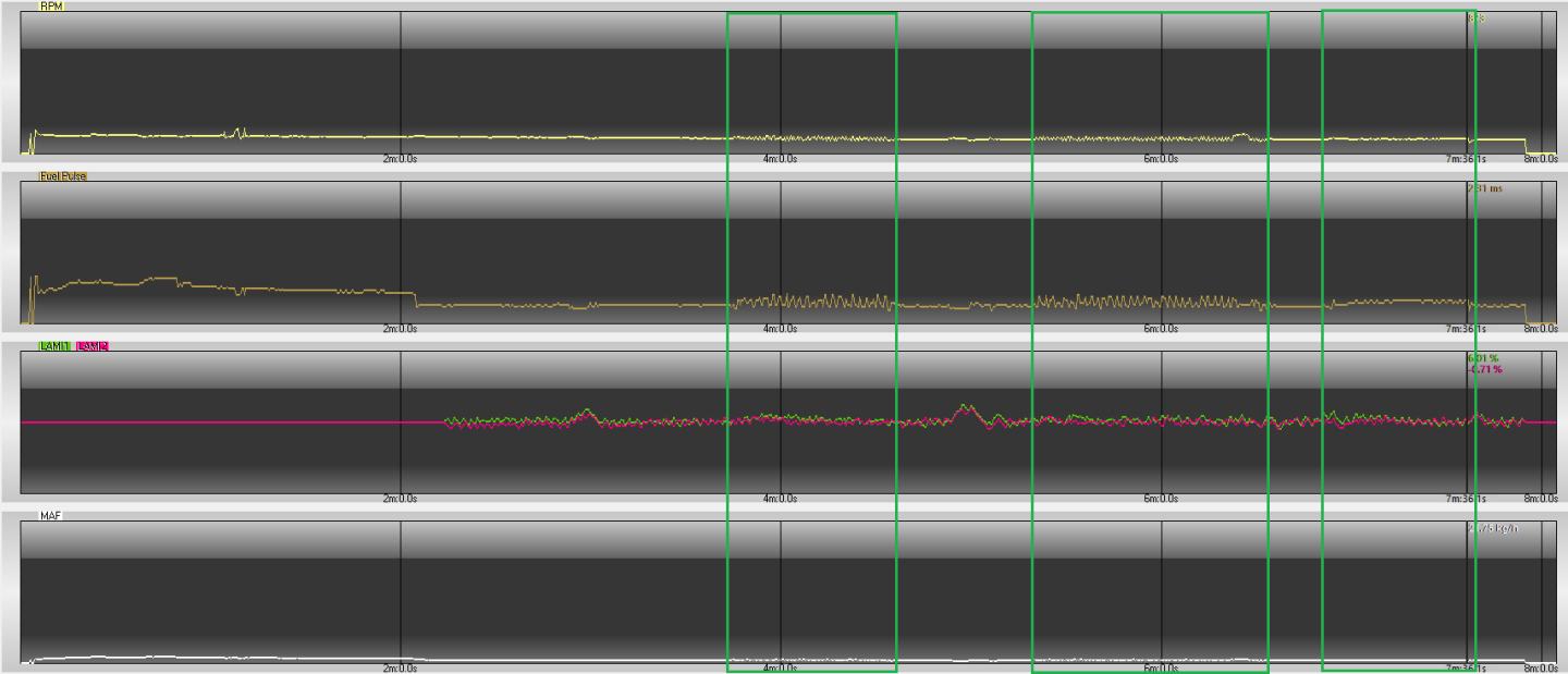

                I did a data log over the weekend with HRTuning's "BMWLogger" software, letting the car start from cold, warm up for a couple minutes, and then turn the AC on and off. You can see the green boxes below indicate where I turned the AC on. 2 of 3 times, RPM fluctuated. 3rd time, it held stable (though the rpm did bump up a bit and could feel the load). Strange.
                Click image for larger version  Name:	image.png Views:	0 Size:	95.6 KB ID:	284405

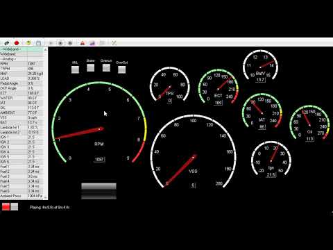

                I also took a screen grab video of the sensor data while the fluctuations were happening that Bryson and I are reviewing - if anyone else sees anything interesting, let me know:
                Since this fluctuation also happened with the intake off, and now with the Mullet tune, I'm wondering if perhaps the iss​ue stems from the AC system being overcharged or something. I will order some cheap AC gauges and check pressures on the high and low side.

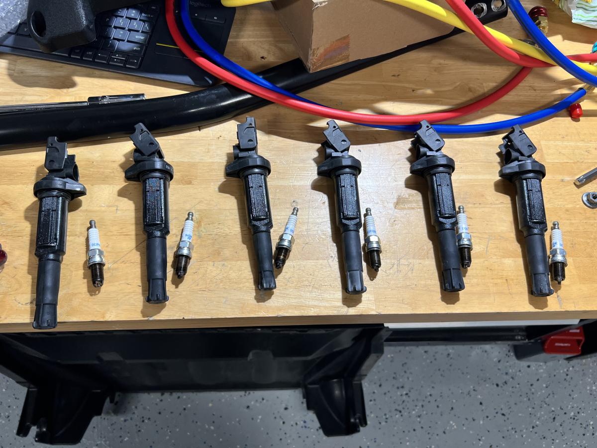

                        i don’t see a *major* smoking gun with the spark plugs or coils, but the coils are definitely original.

                          Try Changing the coils and plugs and lets see what it does, they would have to be really bad or some of them really bad for the car to be doing this.
                            #88
                            After I took that picture, I did notice something interesting about the third coil from the left. The rubber boot is soft on the other 5, but that one is rock solid hard, and has shrunk. On the others, the spark plug would click in nicely. On that one, I couldn't get the spark plug to click into place. The boot actually broke off while I was trying.
                            I don't really think that's all of the problem, and I wasn't getting misfire codes, but it could be something. The coils had an 11/06 date code on them, so they're pretty ancient and ready for a replacement. At any rate, new spark plugs are in, new Eldor coils going in this afternoon, we'll see what that does.
                            New O2 sensors arrive today, so they'll be up for replacement tomorrow.
                              Also don't forget the new Bosch coils do not click anymore when seated.
                                #90
                                I ordered Eldor ones because they were consistently very highly regarded across a few forums. I know Bosch is an industry standard, nothing wrong with them, but folks were actively singing the praises of Eldor versus saying "Bosch are fine too" so I'll give Eldor a shot.
