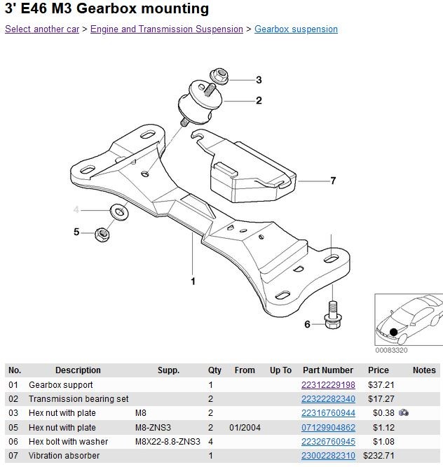

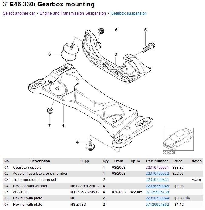

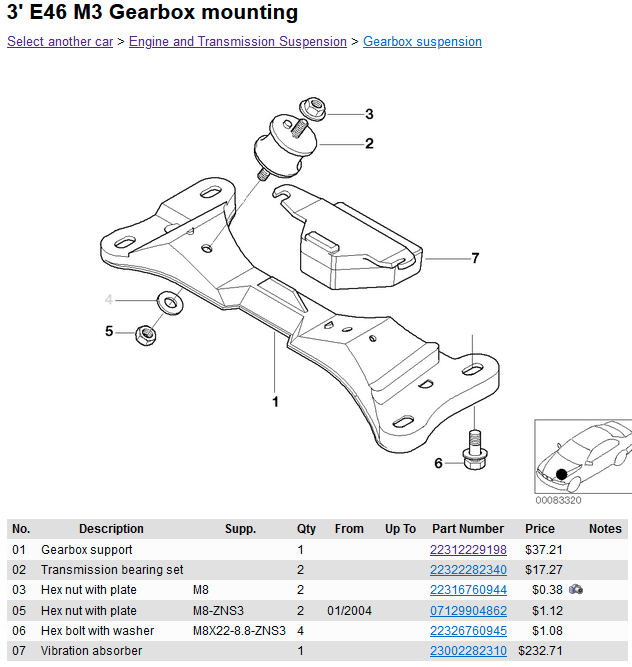

                          Any idea what would be involved in installing a S6-37 into an M3? As in...
                          Would it need a different driveshaft length? If so, any chance you know what it is?
                          Shift-- what is different, exactly?
                          Cross member looks quite different, and has an addition bracket (2 on the diagram). What's the extra bracket do? Does the cross member install in the M3 without any changes?
                          I suspect a CF driveshaft is in my future, and I already want to change my shifter setup to a 0% reduction AS kit, AND my flywheel is still original at nearly 170,000 miles... so if I was ever going to do this... now might be the time (get it made to length for this swap and get shifter parts that are friendly to the swap).
