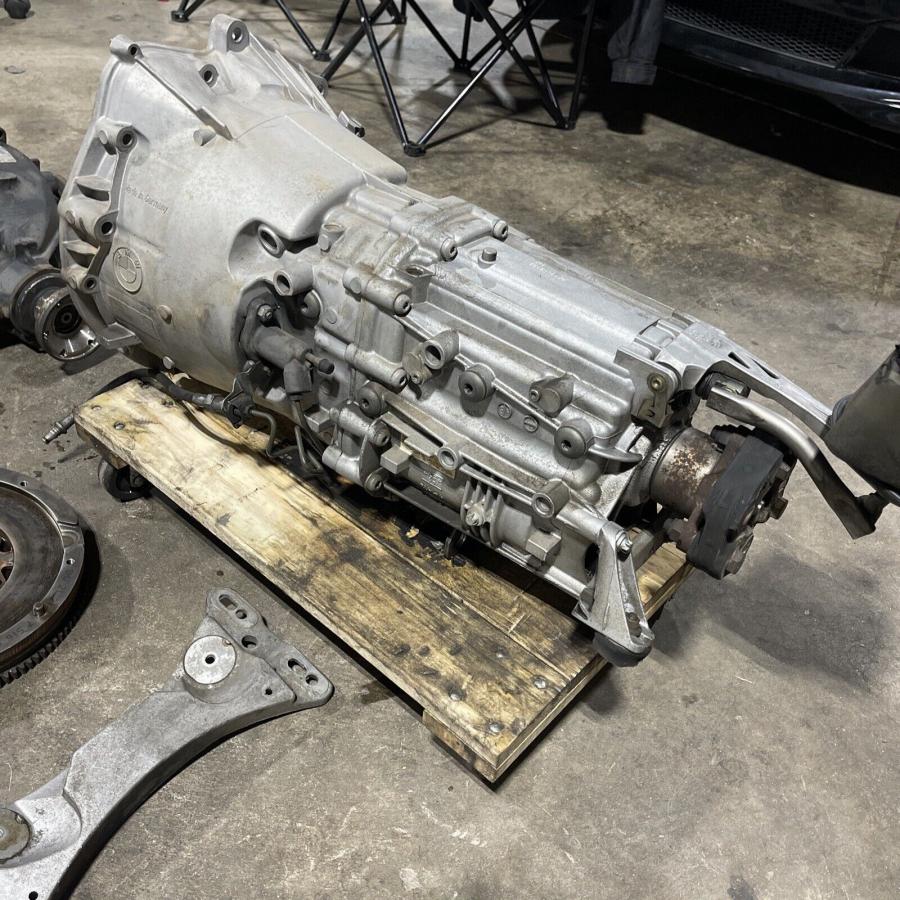

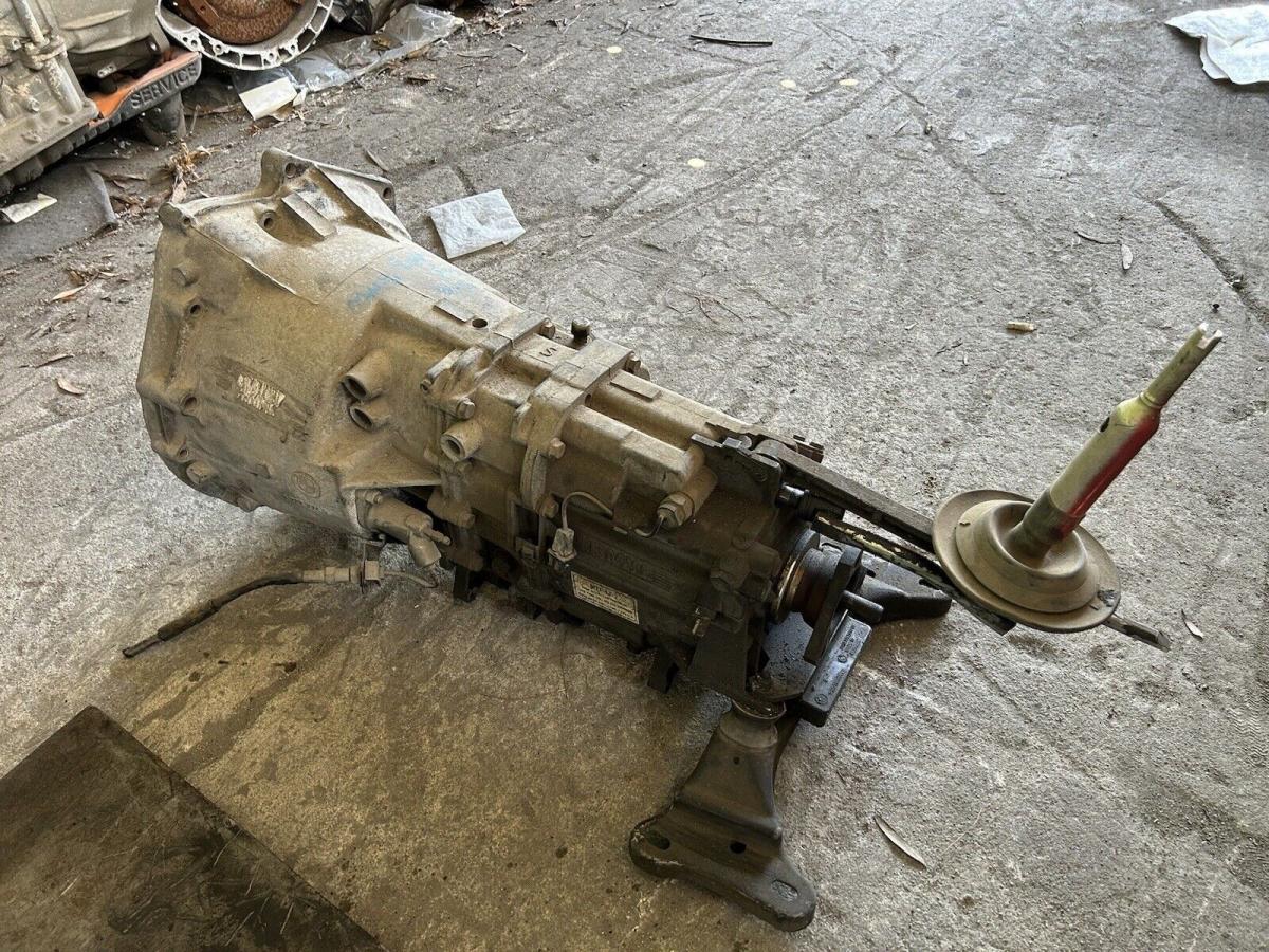

        Don't have measurements, but judging from pictures, it'll be very close:
        420G:
        Click image for larger version  Name:	s-l1600.jpg Views:	0 Size:	279.0 KB ID:	235609
        S6-37:
        Click image for larger version  Name:	s-l1600-1.jpg Views:	0 Size:	160.2 KB ID:	235610
        That S6-37 is out of a 330i, so shifter location should be the same as our cars.
        George Hill might have a better answer though. I think he's done a couple of these swaps

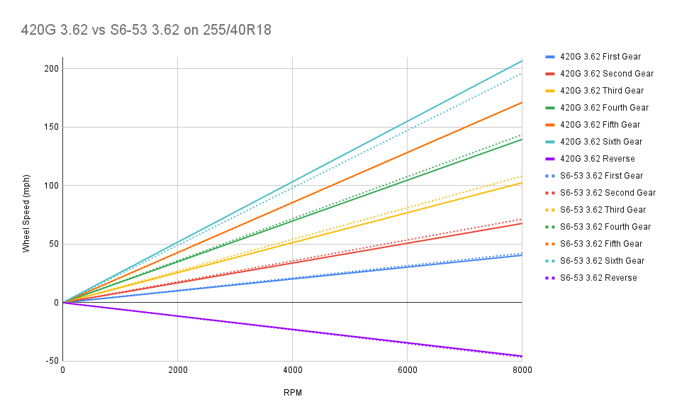

                  I know this is a junkyard thread and not a transmission swap thread, but I did some math this morning and figured I'd share.
                  Here's the difference in rear wheel speed between the 420G and S6-53, all else equal:
Name:	420G 3.62 vs S6-53 3.62 on 255:40R18.png
                  Longer 1st-4th, same 5th and shorter 6th.

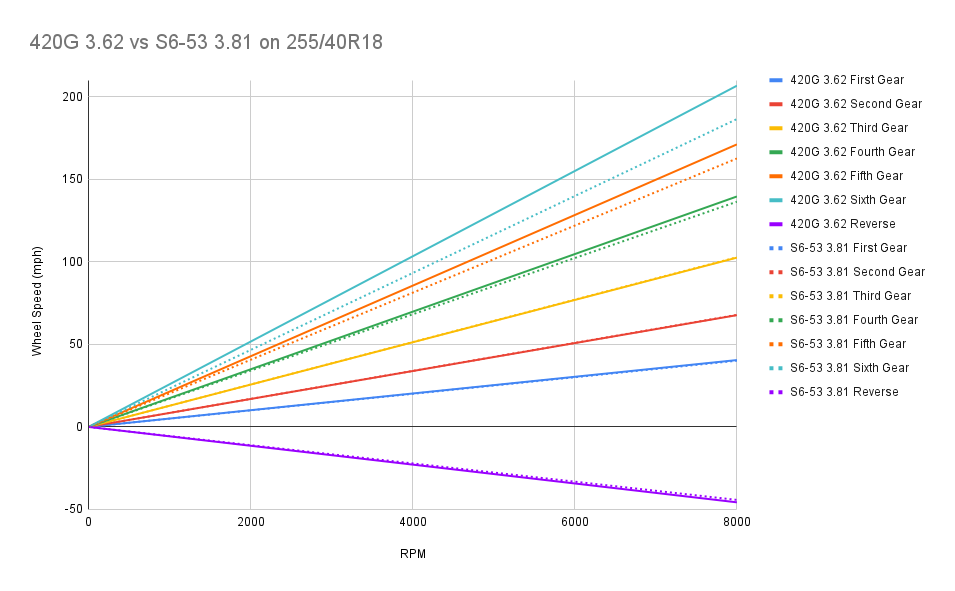

                  And here's the difference in rear wheel speed between a 420G with a 3.62 diff and a S6-53 with a 3.81 diff:
Name:	420G 3.62 vs S6-53 3.81 on 255:40R18.png
                  Pretty much identical 1st-3rd and shorter 4th-6th.
                  So, if you like the M3 factory gearing and want to swap in an S6-53, you should budget for a diff gearing change as well.
