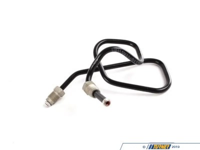

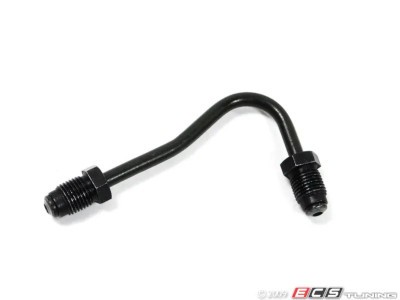

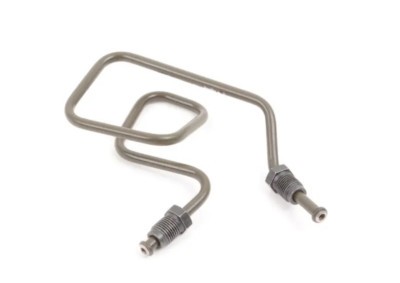

Little OT, but anyone know why the 330i/Z4, 330xi, and M3/Z4M use different clutch hardlines between the softline and the slave? That's 21526774230, 21526753015, and 21522229675 respectively.
If the M3 (420G) and Z4M (GS6-37) both use the same-P/N shortest-path hardline, and the hardline-to-transmission support bracket follows the trans (21526774227 and 21522229699,) and all cars use the same slave (21526785966,) then I think the hardline endpoints have to be in the same location in all configurations, so why do the non-S54 cars use different hardlines?
The softline is different for Z4s, but that makes sense since the length of the run differs with the chassis. Even the clutch pedals are the same across all E46s (35311163870). Is BMW controlling pedal feel and damping vibrations in the hardline? How could that work if it's well-bled - fluid volume? Bend radii producing resistance?
Thanks guys.Last edited by ethan; 09-05-2025, 05:59 PM.
