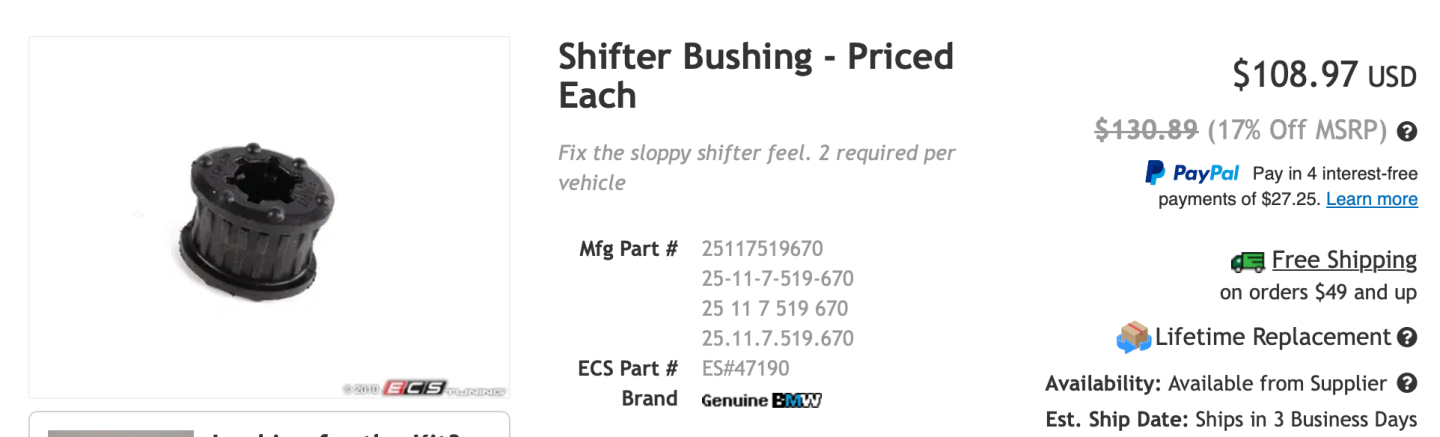

                        If you’re doing this conversion, be sure to grab as many of the donor e46 330i parts as possible, as they’re skyrocketing in price.
                        Exhibit A (you need two of these, which is insulting):
