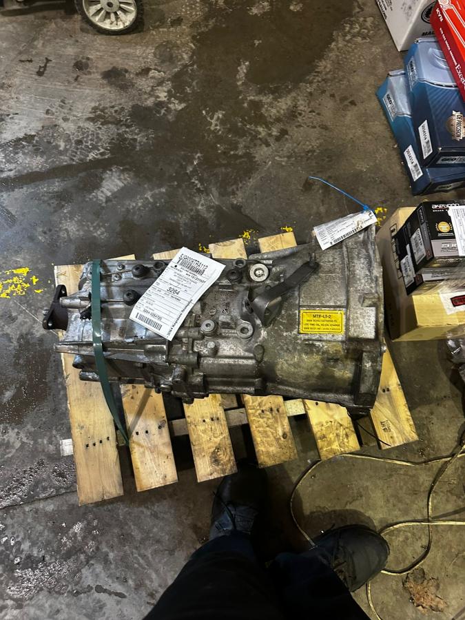

    This just got shipped in, snuck this one from a wrecker who had it priced for cheap. Contacted Ronald to see if he can make an SSK for me hoping to get one from him by end of January.
    Just so you guys know, the ZF 6-Speed in the E46 330i is also used in those early E60 525/30's with the M54 engine. I think it was 04-06 E60. I found mine like this priced under market value from car-part.
    Did you ever make the tranny swap? Any reviews/insight you can provide would be appreciated. Thanks...

      I'm probably still a month or two away before I bring the E46 M3 back home to finish the build. Just waiting on my engine builder to get the motor back together and I'll be sure to post updates here for everyone.
      I have since acquired a few more transmissions. One of them is from a Z4M, one from an E60 530i, and the other 2 from E46 330's.
      Apparently the Z4M input shaft is a bit longer than the 330 variant, I'll get em all side by side and carefully inspect the differences. From the outside they look identical, also the Z4M uses the same flywheel as the E46 M3, but has a unique clutch setup.
