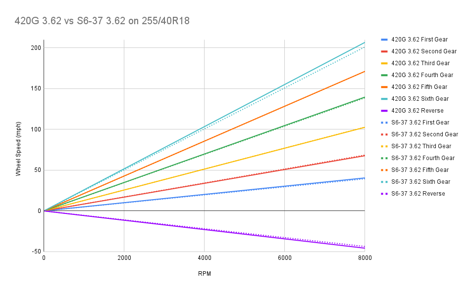

      On the plus side, S6-37 gear ratios are super close to the 420G, so no diff swap needed. Only meaningful difference is a shorter sixth, but that's okay.
      I'll post the comparison graph when I'm back at my computer
      Edit:
      Here's 420G vs S6-37, all else equal:
      Click image for larger version  Name:	420G 3.62 vs S6-37 3.62 on 255:40R18.png Views:	0 Size:	91.5 KB ID:	236269

            Not trying to be pedantic, so apologies in advance if this ends up coming out that way, but the ratios are multiplicative not additive.
            Technically, an M3 with an S6-37BZ and a 3.62 diff will have the same final drive ratio in first gear as an identical M3 with a 420G and a 3.725​ diff. Yes, not hugely different to the number you mentioned, but it's a 2.9% decrease in ratio vs a 3.3% decrease.
            The difference between a 420G and an S6-37 is so small in 1st and 2nd that you can easily make it up with different tire sizes. At 2.5k rpm in 1st, you'll be going 12.7 mph with the 420G and 12.3 mph with the S6-37BZ.
            You do raise a very valid point, but I guess what I'm trying to say is that in real life the difference should not be hugely noticeable.
            And yes, 6th is a different story, but also not as dramatic as the graph I posted above makes it seem! To cruise at 80 mph with a 420G, you're looking at right around 3100 rpm. Same speed with the S6-37 is right around 3200 rpm. Noticeable difference, but not hugely so.
            Also, worth keeping in mind that this is all dependent on tire size. All my calculations have been done with a 255/40R18 rear tire size (stock) and if you stay close to that tire diameter, the numbers should be very, very close. Tire diameters that differ significantly will change things.

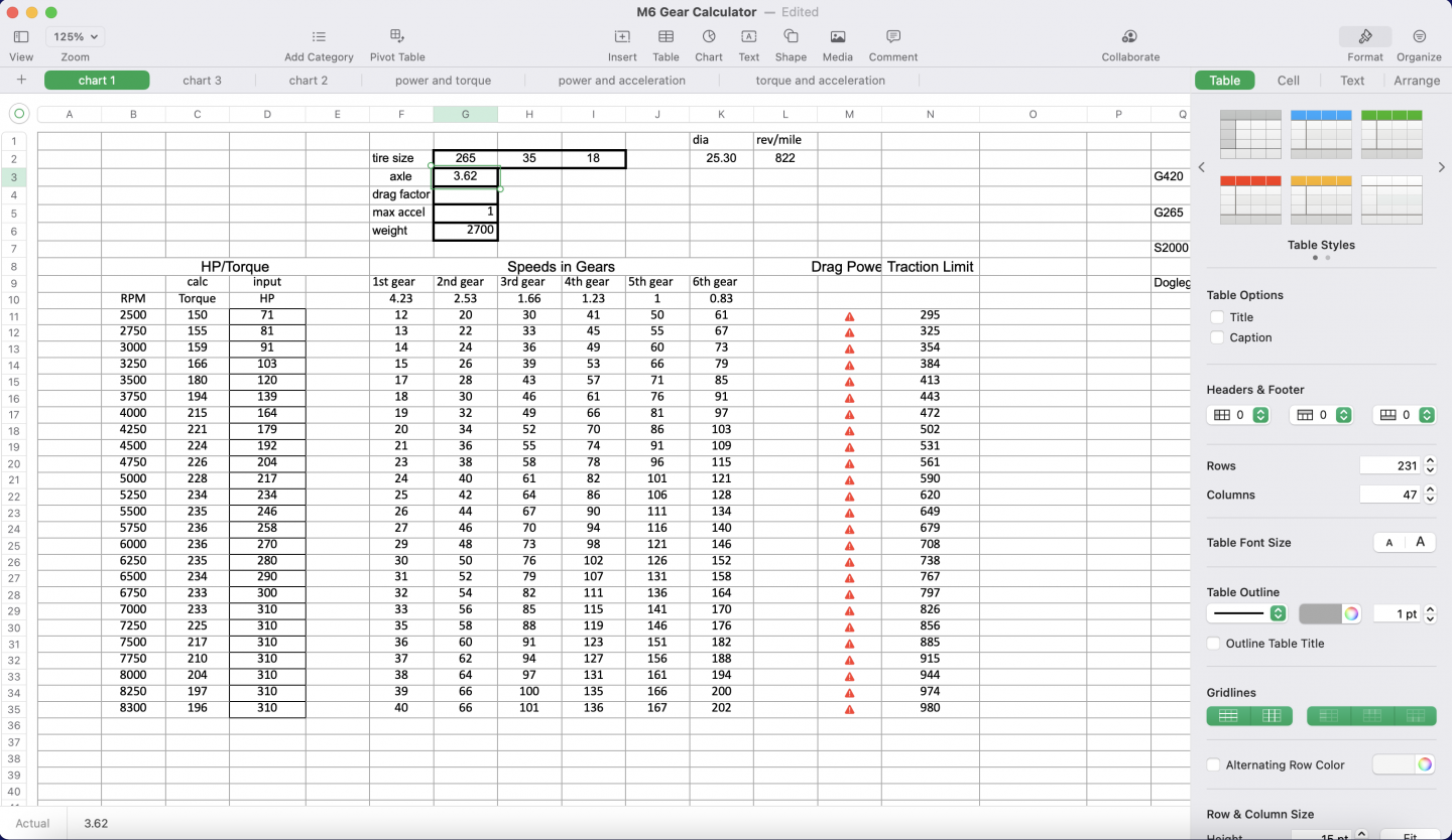

                The chart you post is fine but because the curves are not
                very clear vs speed vs rpm and it makes it little bit confusing
                not as clear as the chart bellow. I made very nice excel charts
                so I can see things in close details when I calculate tires size,
                vs HP vs TQ vs RPM vs Speed etc.
                It's like dyno-chart if you print the chart to show the HP vs RPM
                in say 20rpms increment vs a curve.
                In the chart I made for us here pay attention on the speed
                vs rpm vs RPM drop vs TQ vs speed.
                So now if you look at the HP chart vs the SG6 rpm drop then
                you will see loss of HP not by much but S54 needs every single
                hp and tq in the world.

                Click image for larger version  Name:	SG6.png Views:	0 Size:	523.2 KB ID:	236330
                Click image for larger version  Name:	G420.png Views:	0 Size:	468.8 KB ID:	236331

                            In order to calculate the effective final drive ratio one
                            needs to take the gear ratio and multiply by the differential.
                            SG6 4.35x3.62=15.747 effective final drive.
                            G420 4.23x3.62=15.312 effective final drive
                            Something to suggest when you compare setup it does not
                            matter what it is you need to be fair and measure the rest to be
                            the same, in this case will be use the same tires size for both
                            gear box comparison. Because if you tweak one you can tweak
                            the other as well.
                            The rpm drop from from 1st to 2nd will affect the HP with around +/5-RWHP
                            and that is +/-9hp at the crank I can make the chart even closer to each other
                            but its a lot of work..the point I am making I think its understood.
                            I agree whit you, this is very small detail which will not be noticed day to day
                            driving but 0-60mph selling nonsense it does make a visual difference
                            if its 5sec vs 4.8sec its a window sticker mind game...back in the year of 2000.
                            (If anybody wants help with the differential gear ratio for the track, or tire size
                            let me know I will apply the data and reply)
                            Regards,
                            Anri
