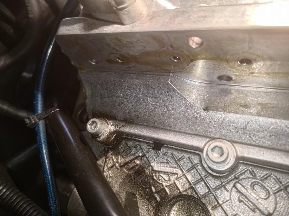

    I noticed a fairly slow leak from the lower seal between the VANOS unit and my engine block, about here:
    Click image for larger version  Name:	image.png Views:	0 Size:	27.7 KB ID:	233630
    You can see this in the image I attached to the thread.​
    So, to fix this, I'm guessing I will have to slightly pull the VANOS unit back from the head, enough to drop the old gasket out and replace it. Any other suggestions to avoid all that work for a little gasket?

    Inspect hub tabs and cam bolts. If there is an issue then dig into it more. You can remove the VANOS without affecting timing. Good video here:
    Pro Tip: when installing the new vanos gasket make sure to clean both surfaces. But be careful with abrasives as the aluminum is pretty soft and easy to deform. I use 3M red scotchbrite pad.

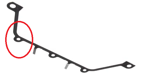

    Apply a thin layer of toyota FIPG around the bottom left bolt hole on the head side (the circled area in your photo above)
      That noise is completely normal. An easy way to verify that the previous owner did the VANOS work is the look at the VANOS oil pump disc. It should have four holes and marked BS on the face of the disc.
      The VANOS gasket is easy to replace, just follow the BS instructions and clean the surfaces thoroughly before installing the new gasket.

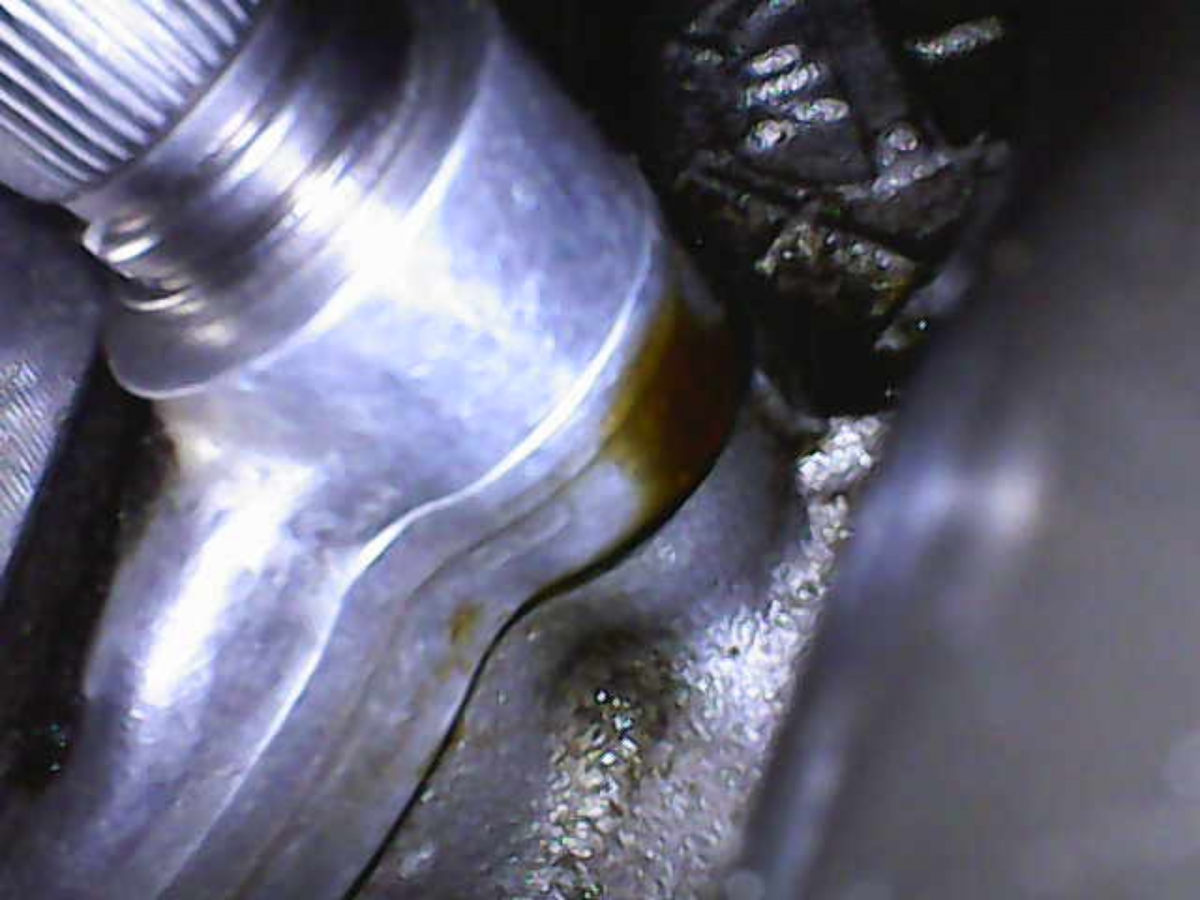

                    There's oil seeping through that gap, and I don't have the budget to do the full vanos overhaul yet, so in the meantime I'll just fix the oil leak until I am financially stable
                      Mine is leaking in same spot, can i just remove bolt, add black silicone to threads of bolt and reinstall?

                        That won't fix the issue, you need to apply a thin film of RTV like dreibond or Toyota FIPG around the perimeter of that bolt hole.
