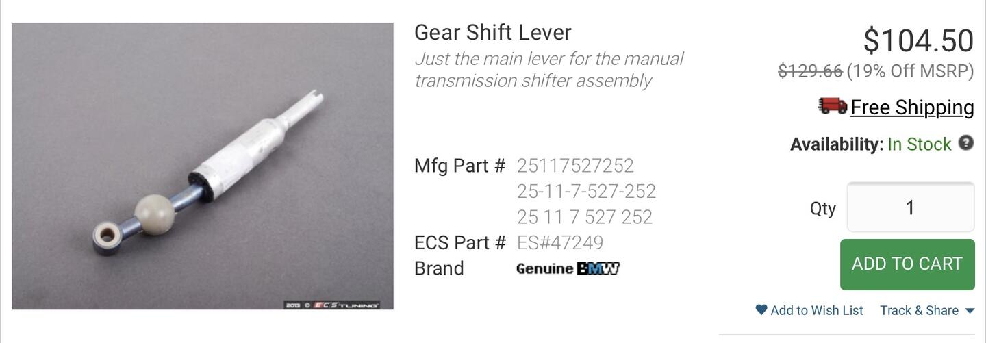

    As for cost, the 330D shifter is roughly $105 dollars (see below). I can’t remember what I paid for my Dinan shifter as that was too long ago. If you can procure it for say less than a Benjamin, ehhh, do it man.

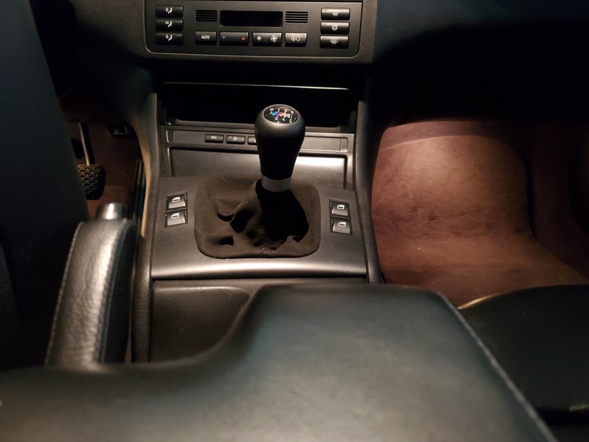

          I just recently removed my 330d lever. I enjoyed it quite a bit, especially for the price. However, as Speed Monkey mentioned, the 330d lever lacks the bend the Dinan on has, which makes it lean to the right. This is it in neutral:

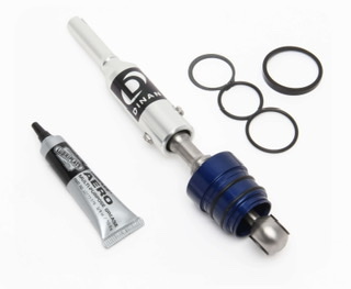

                The Dinan shifter is NOT like the 330D or any OE BMW leveler, perhaps it used to be, but it's not anymore.
                My car came with a Dinan (see pictures below) I did not like it and swapped it out for an e60 short shifter with all new stock bushings. The Dinan was extremely knotchy and about the same height as the e60 - but the Dinan has about 1/2 the throw because of the raised pival bearing. When the car was fully warmed up shifting was fast and quick, knotchy into gears, without much slop.
                The Dinan has a pivot ball that is moved up about 15mm from the stock shifter "ball" pivot by way of a blue aluminum shaft. The bottom of the shaft fits into the stock shifter ball bushing (the white bushing looking thing) and is held in place by a black plastic bushing.
                This is how it mounts into the stock shift level mount. Incidentally, my shifter did not have that black plastic piece and I designed and 3d printed my own.
