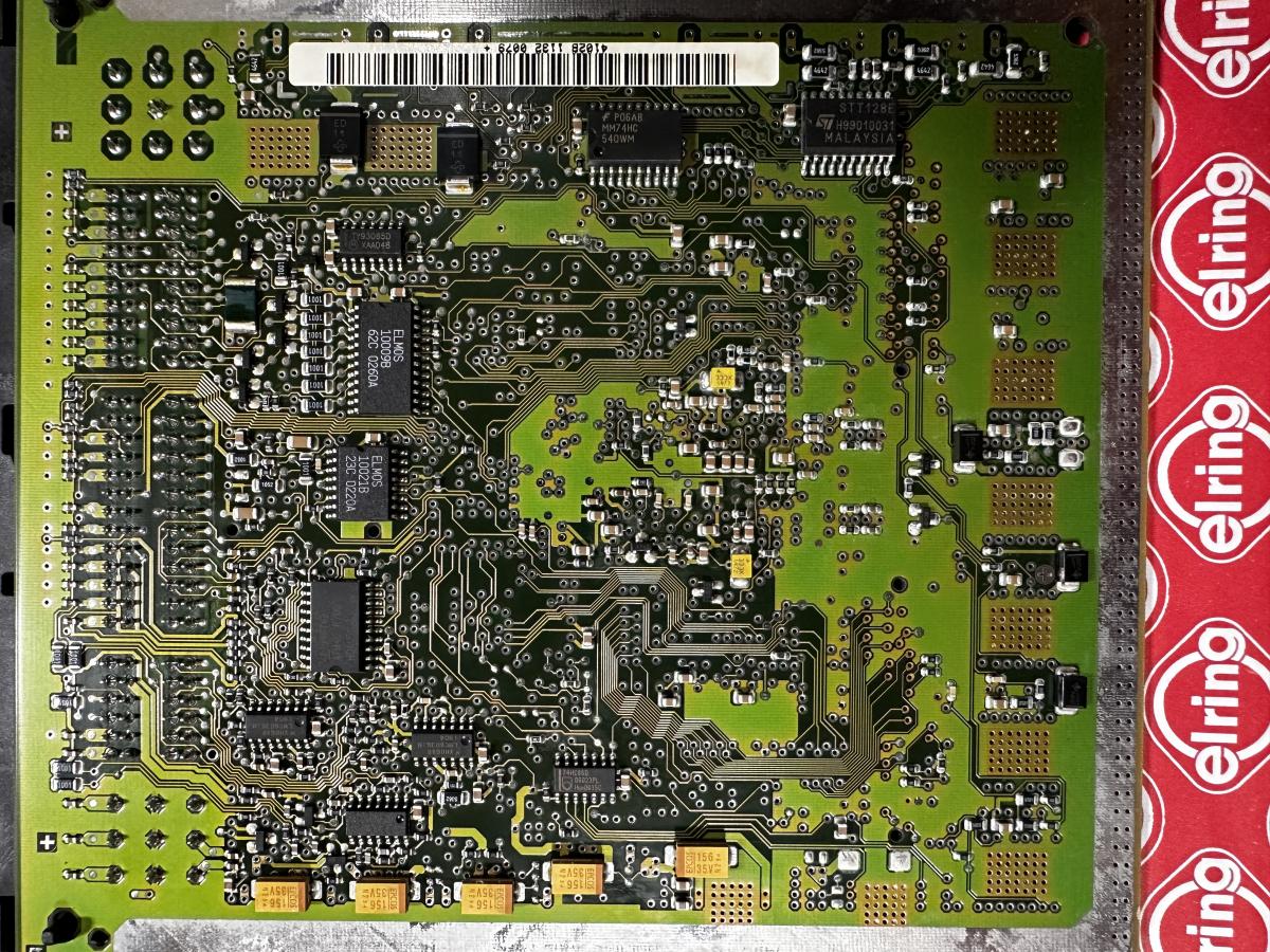

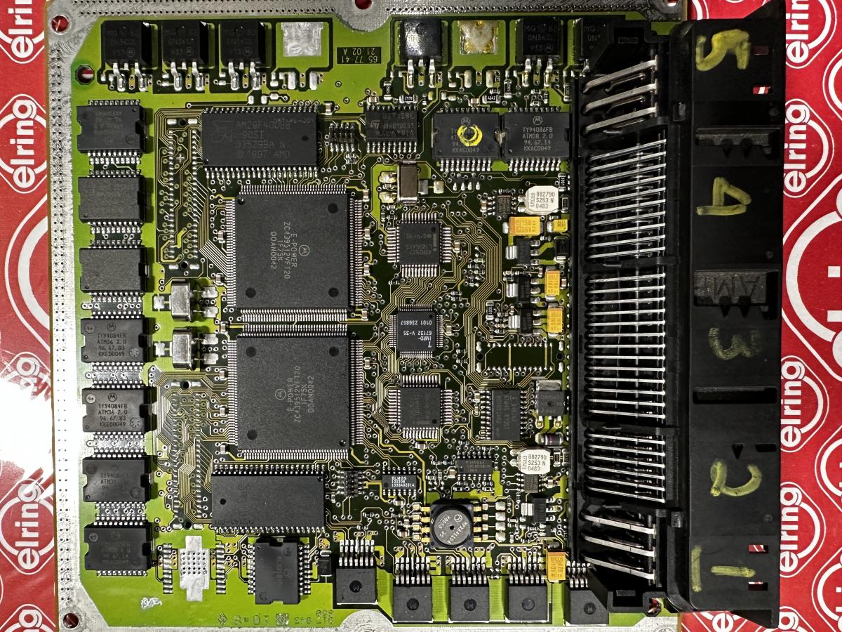

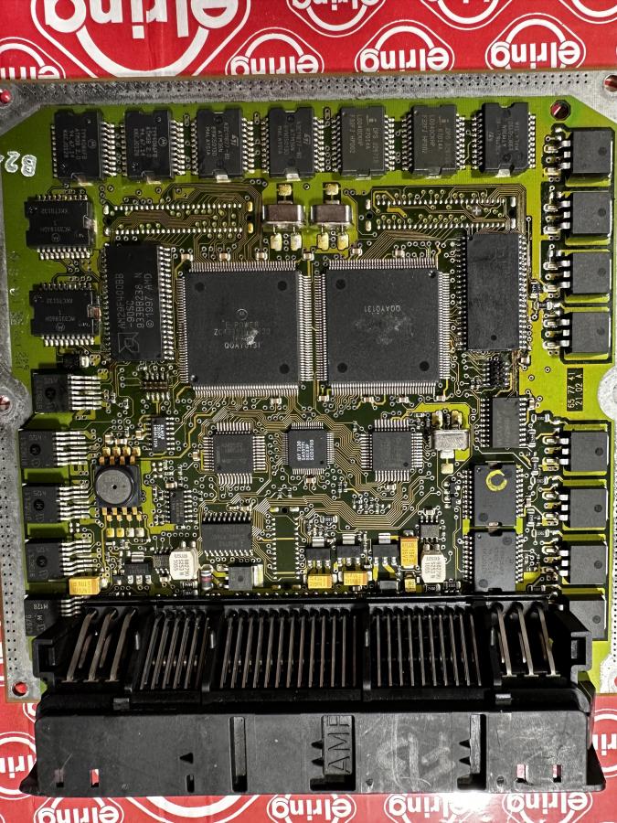

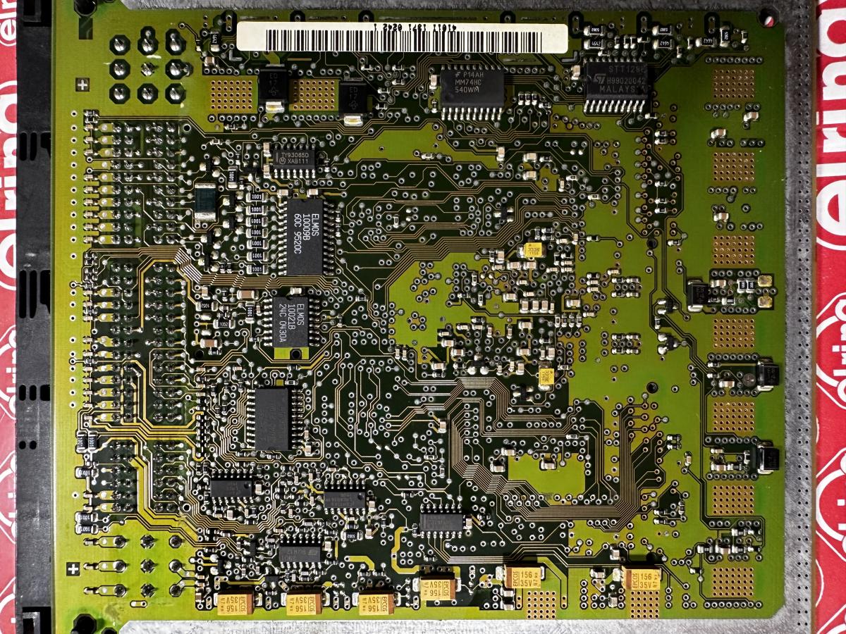

                  I swapped out the DME’s and loaded up my Fullbinary into the Kassel one, starts and runs so I guess I need to get it ready for a proper road test now.

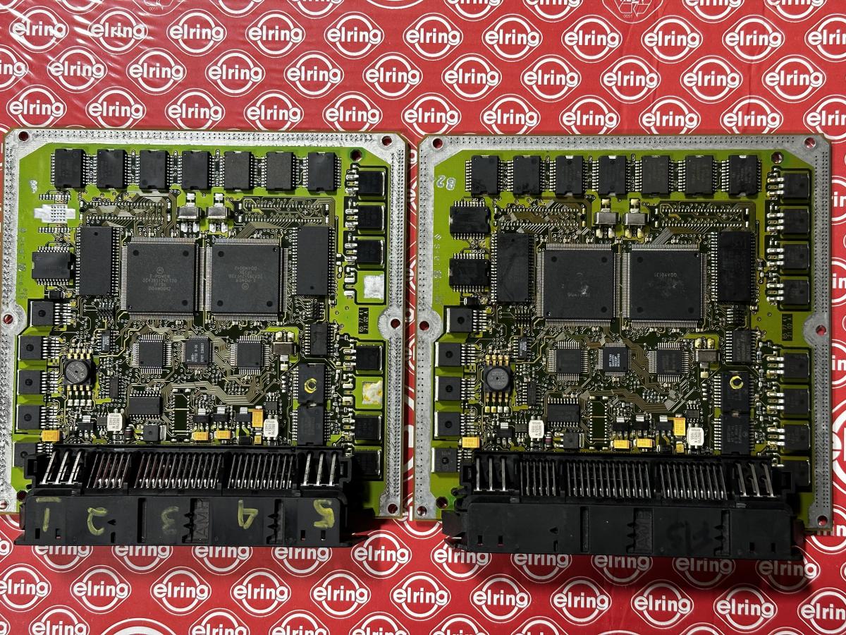

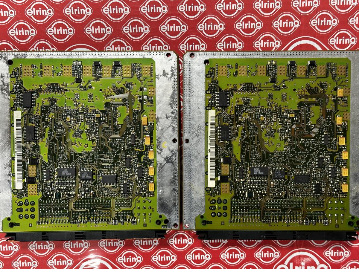

                  I did open up both DME’s to compare, seems like my DME is missing some stuff.
                  My DME is on the left, Kassel one on the right.
                    My DME
                      Kassel DME
                        Hmm, I don't see anything that's obviously wrong with the old DME. It is hard to tell with just pictures though.
                        However, I've never seen an MSS54/HP that has those two MOSFETs on the right populated like on the Kassel one. Maybe they know something we don't...
                        NZ_M3 does your genuine CSL DME have those MOSFETs too?
                          from the looks of it, mine is just missing the stuff for the CSL flap (which I don’t have). I was wondering if those other pieces (MOSFETs) on the right had something to do with SMG? I can’t see what the vin is on the Kassel DME so not sure what trans it was intended for. Mine is definitely for a 6-speed manual.

                            Looks like that DME was originally an mss52. The extra igbts are for the 2 extra cylinders.
                              Aaaah that makes total sense. Thanks for that
                              Also, thanks for clarifying that they're IGBTs not MOSFETs. Am away from my spare DMEs and couldn't make out the writing on them from the pictures I've taken, so I just guessed
