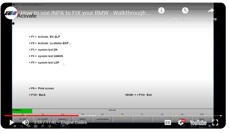

        INPA, select e46 > MS54 (engine)>Activate>Evap (then also click to activate tank leak test)
        F1 and F5 in this pic:

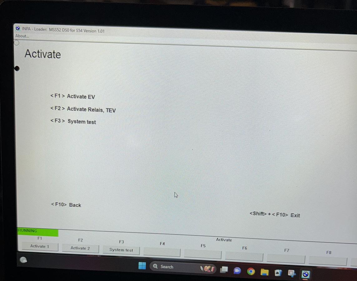

            My menu under activate only has three options

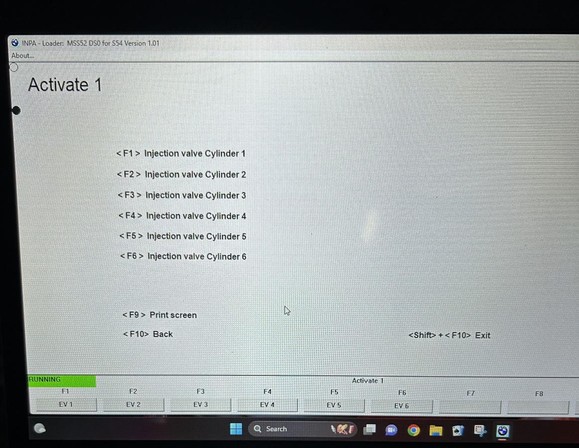

            I tried F1 and it just shows injection valve cylinders (1-6).

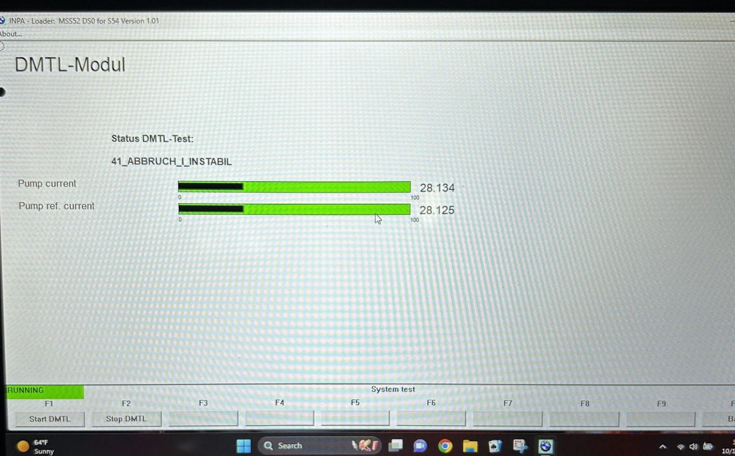

            F3 takes me to test the DMTL, but I'm not sure if those readings are optimum.
            It looks like I'll ultimately have to do a smoke test to find this evap leak which I've never done before
