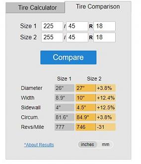

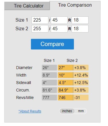

    Here's an example:
    Click image for larger version  Name:	Screenshot_1.jpg Views:	0 Size:	32.3 KB ID:	239911
    Stock is 225/45/18 & 255/40/18, but I've put in 45 for argument's sake.
    So this is saying the sidewall is taller (half inch) - does that mean that the profile # "45" isn't just a measure of side wall to diameter, but width, too, is included in the formula?
    All things being equal, a wider tire shouldn't be taller, just wider. But maybe the wider tire is also taller, but that begs the question - why?

      245/40R18
      Height of sidewall is 40% of 245mm (98 mm, or 3.86 inches)
      Diameter = 18 (wheel diameter) + 7.72" (sidewall height *2), for a total of 25.72 inches
      255/40R18
      Height of sidewall is 40% of 255mm (102 mm, or 4.02 inches)
      Diameter = 18 + 8.04, for a total of 26.04 inches.
      Circumference = Pi * Diameter, so the slightly larger diameter of the wider tire results in a larger circumference.
      As long as the aspect ratio/profile stays the same (40 in this case), then if width increases so does diameter and circumference.

      "does that mean that the profile # "45" isn't just a measure of side wall to diameter, but width, too, is included in the formula?"
      The profile/aspect ratio is really a measure of the height of the sidewall as a percentage of width. Sidewall height is the product of profile and width.
      Old, not obsolete.
        Unclear if you grok this, so if I'm saying something you already realize then ignore me...
        The middle number/aspect ratio is a percent of the tire width-- not of the diameter.
        In your example, the aspect ratio is 45, meaning the sidewall is 45 percent as high as the tire is wide (225mm). So, as the tire gets wider at the same aspect ratio, the sidewall gets taller.
        It's a stupid system, but it's the system we have.
        ... D-O replied while I was typing
          Hmm, I think there two separate questions here. One about rolling circumference vs tire diameter and another about how aspect ratio relates to sidewall height.
          The answer to the rolling circumference question is basically that tires are squishy. Because of this, the tire will not be perfectly circular with the vehicle weight on it. This means that the distance a tire travels in one revolution (rolling circumference) is not exactly directly proportional to the tire's (ideal) diameter. If the tire were perfectly rigid and did not deform, then rolling circumference would equal tire_diameter * pi. Tires are not perfectly rigid though, so rolling circumference is actually the aforementioned value plus some factor that is dependent on a bunch of stuff (tire wear, tire material, sidewall stiffness, tire pressure, surface geometry, etc.).
          The answer to the other question comes from what the aspect ratio is. The aspect ratio is a multiplicative factor used to calculate the sidewall height based on the tire width. For example, the "45" in 225/45/R18 means that the sidewall will be 45% as tall as the tire is wide. In other words, the sidewall will be 225 * 0.45 = 101.25 mm tall. On a 255/45/R18, the sidewall will be 255 * 0.45 = 114.75 mm tall. So the aspect ratio isn't directly telling you how tall the sidewall is, but rather how it relates to the tire width, hence why a wider tire with the same aspect ratio is taller.
