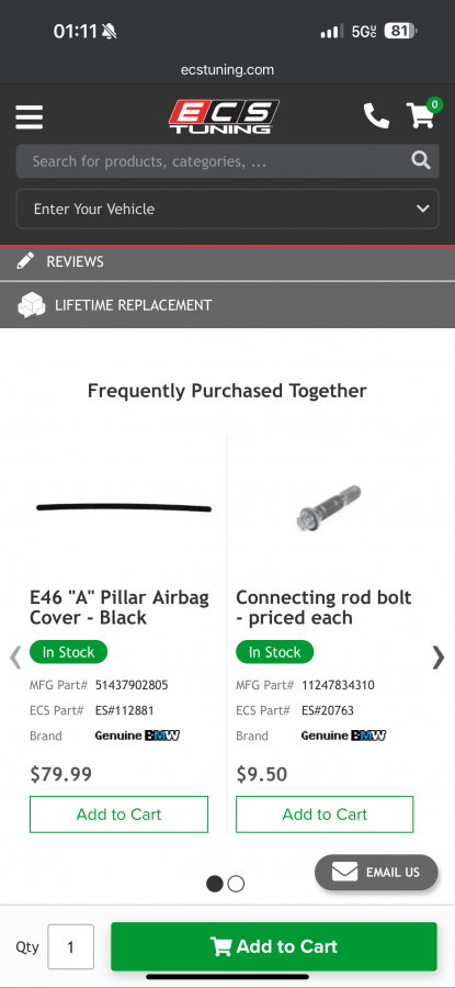

Originally posted by LSBNick View Post
Drop that link
Looks like they went up 30 bucks since I bought mine.
2004 Dinan S3-R M3
2023 X3M Competition
And the C pillars are $270 a piece....Originally posted by 9kracing View Post
https://www.ecstuning.com/b-genuine-...t/51432699054/
