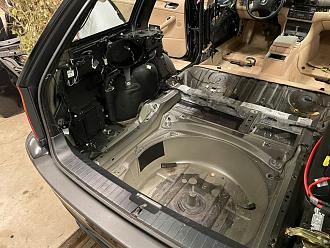

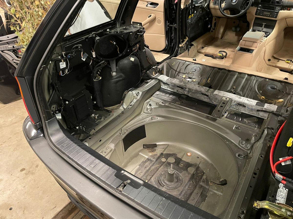

          Old pics...the interior is all back together again BUT I may just run RCA anyways since I'll be replacing the head unit (Alpine ILX-705E46) has been order and should be in hand soon.
          Fair point about DSPing. One thing is I don't think I'll be selling anytime soon, considering how much I put into it. I intend this to be a forever car unless someone offers something I can't refuse.

              Good to know. Looks like Wicked might not have an enclosure for a touring so I need to keep looking for options.
                What does the touring trunk look like? Do you get one of those flaps that covers a little well underneath?
                It kinda looks like it from the pic with the interior stripped out. Hard to tell how big that well is tho.
                Im running this in my X5, it fits down in the well area, but I think your well is smaller than mine.

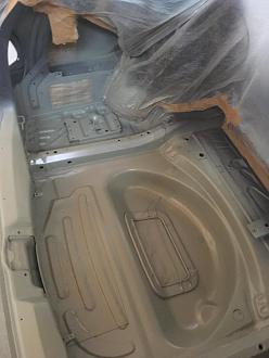

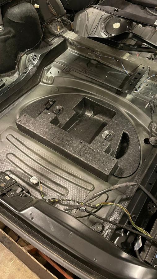

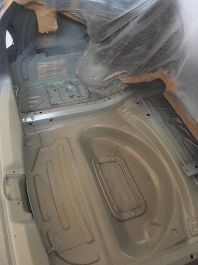

                  That's an old pic. The standard spare tire well has been cut out and now has the M3 rear:
                  Before:
                  During Conversion:
                  After:
                    Oh wow cool.
                    Yeah idk what you're going to do lol

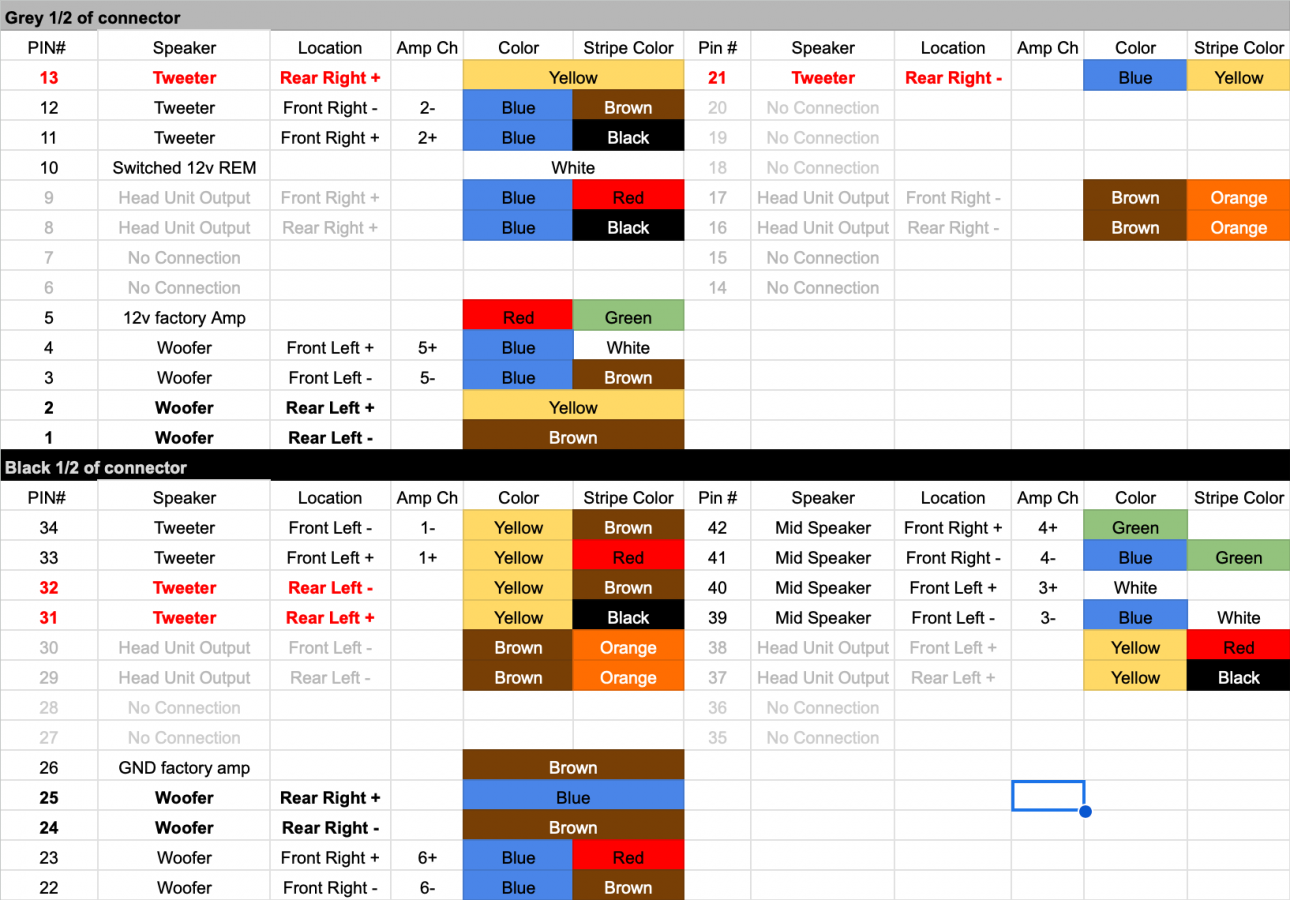

                        I use the JBL DSP4086 and an external sub. Soldered all the wires to the factory HK connector board so that none of the wires are cut and made it sit on the stock bracket. Really nice sound and you have the freedom of DSP tuning. You can find these for under $300.
                          Actually, I've been considering this. Which HK connector board are you referencing? How did you deal with the 3-way components in the front doors? Are all on separate channels, or did you add a passive crossover of some sort? Tried planning out the best channel assignment based on the current wiring, but even with 8 channels, I'm struggling. I mapped these out so far, but not sure how best to use channels 7 & 8. Using channel 1-6 only cover the fronts.
